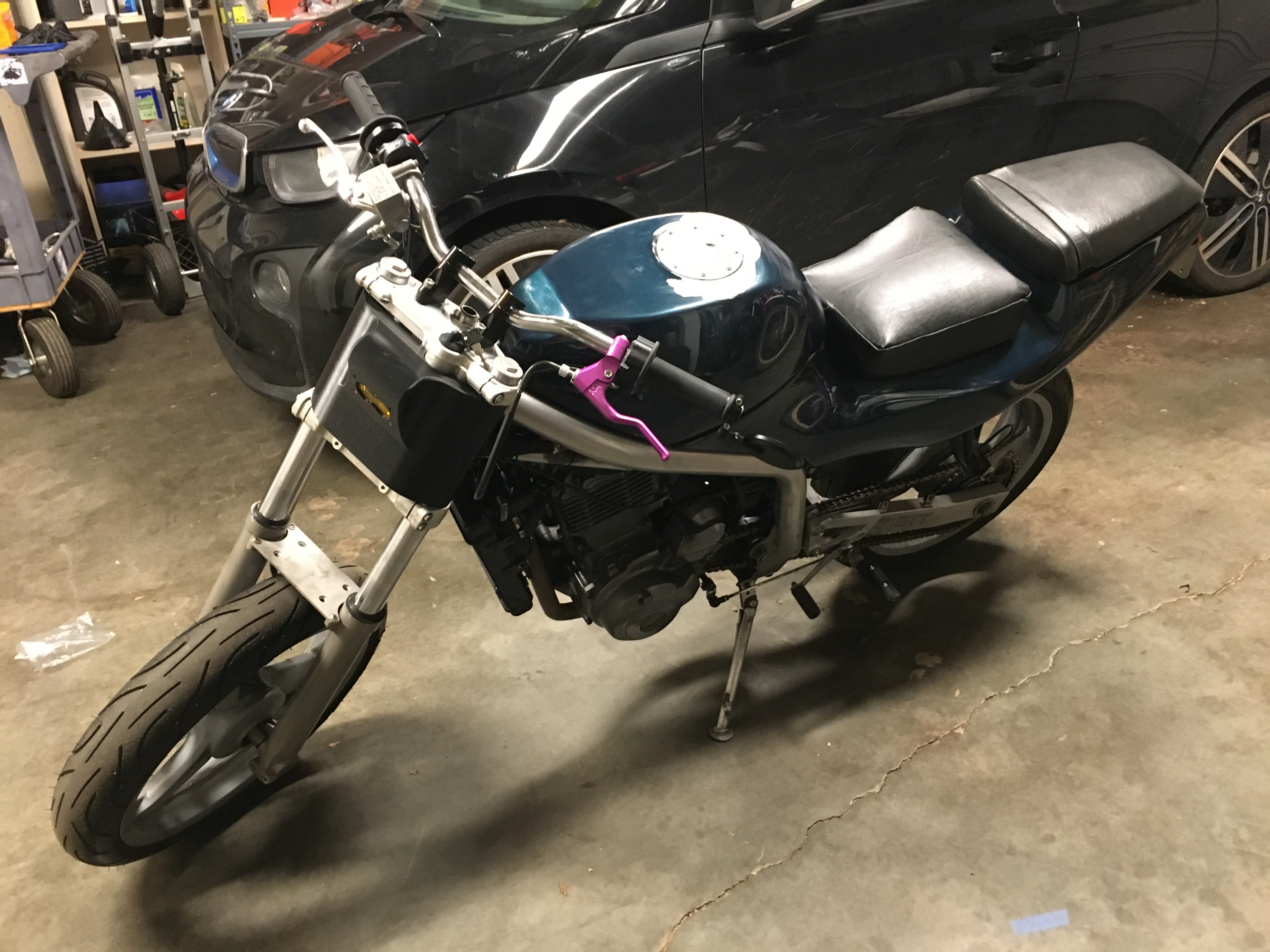

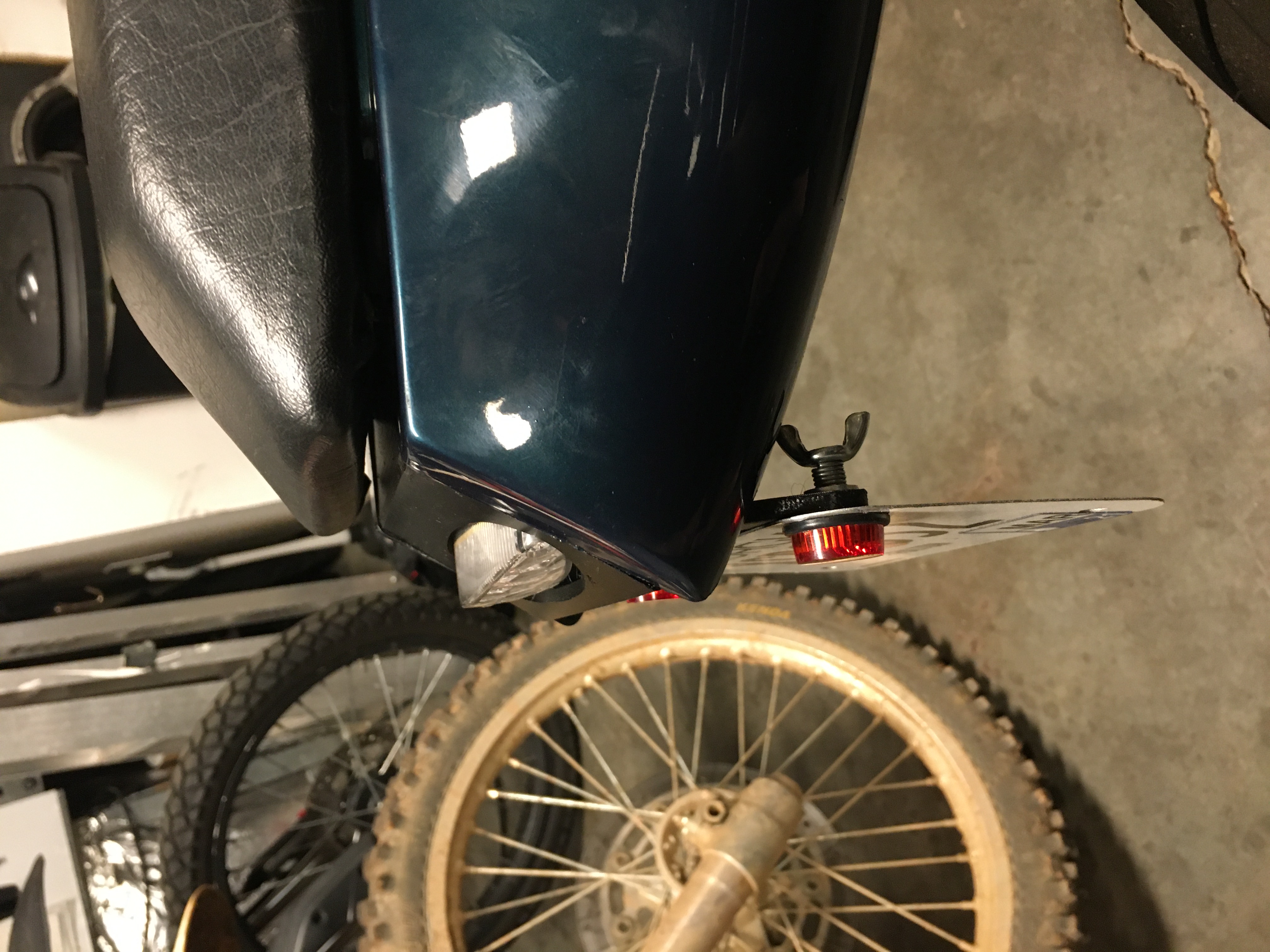

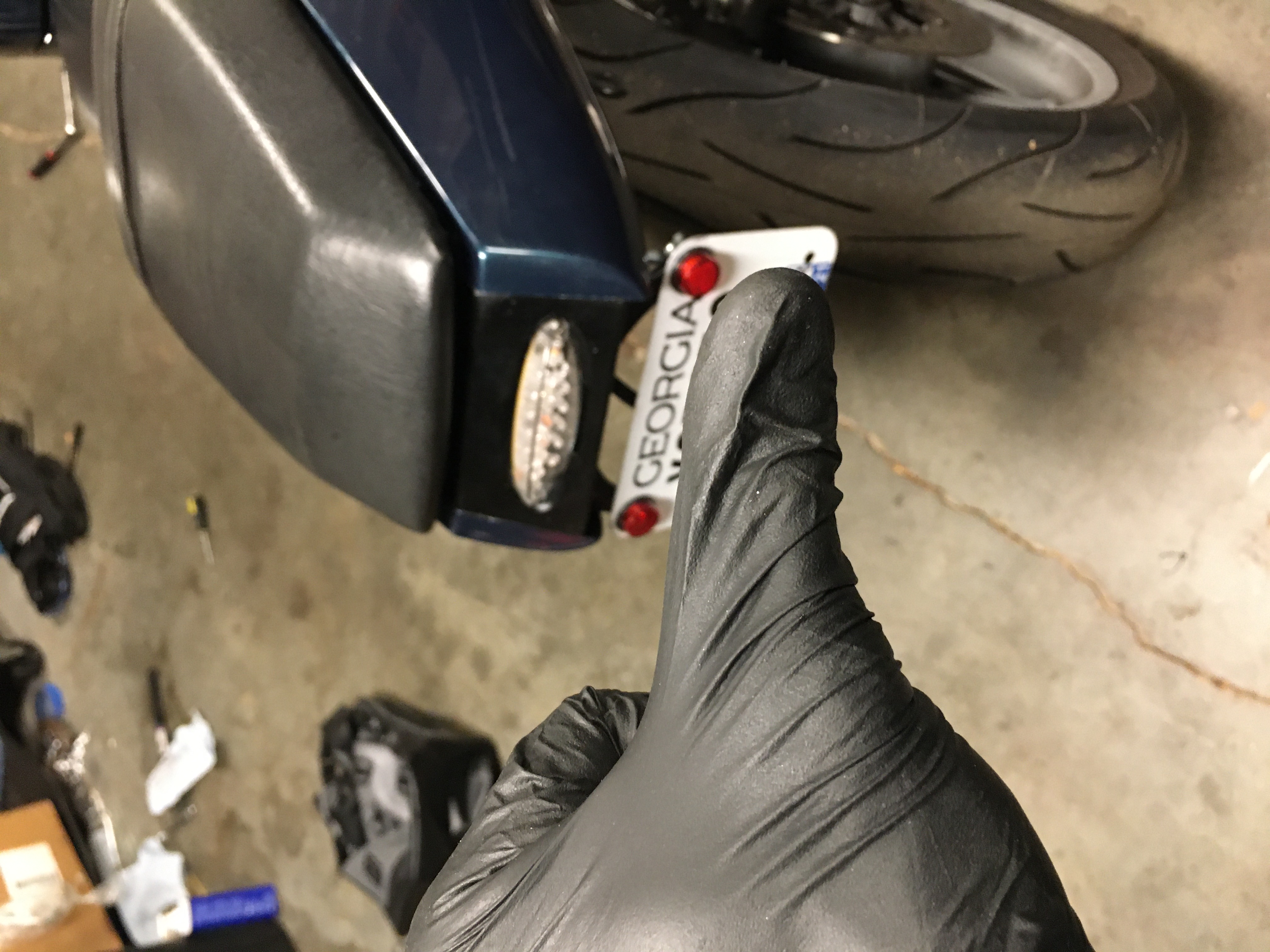

I went through some doubting times of what to do bodywork wise on the skorpion. I have decided for the time being to just keep the stock side panels on and work around them in the design. the last couple of days i have done a talilight that used my lighter LED tail light and looks fairly good. there will be another revision at some point, but I'm happy enough to ride around with it for now.

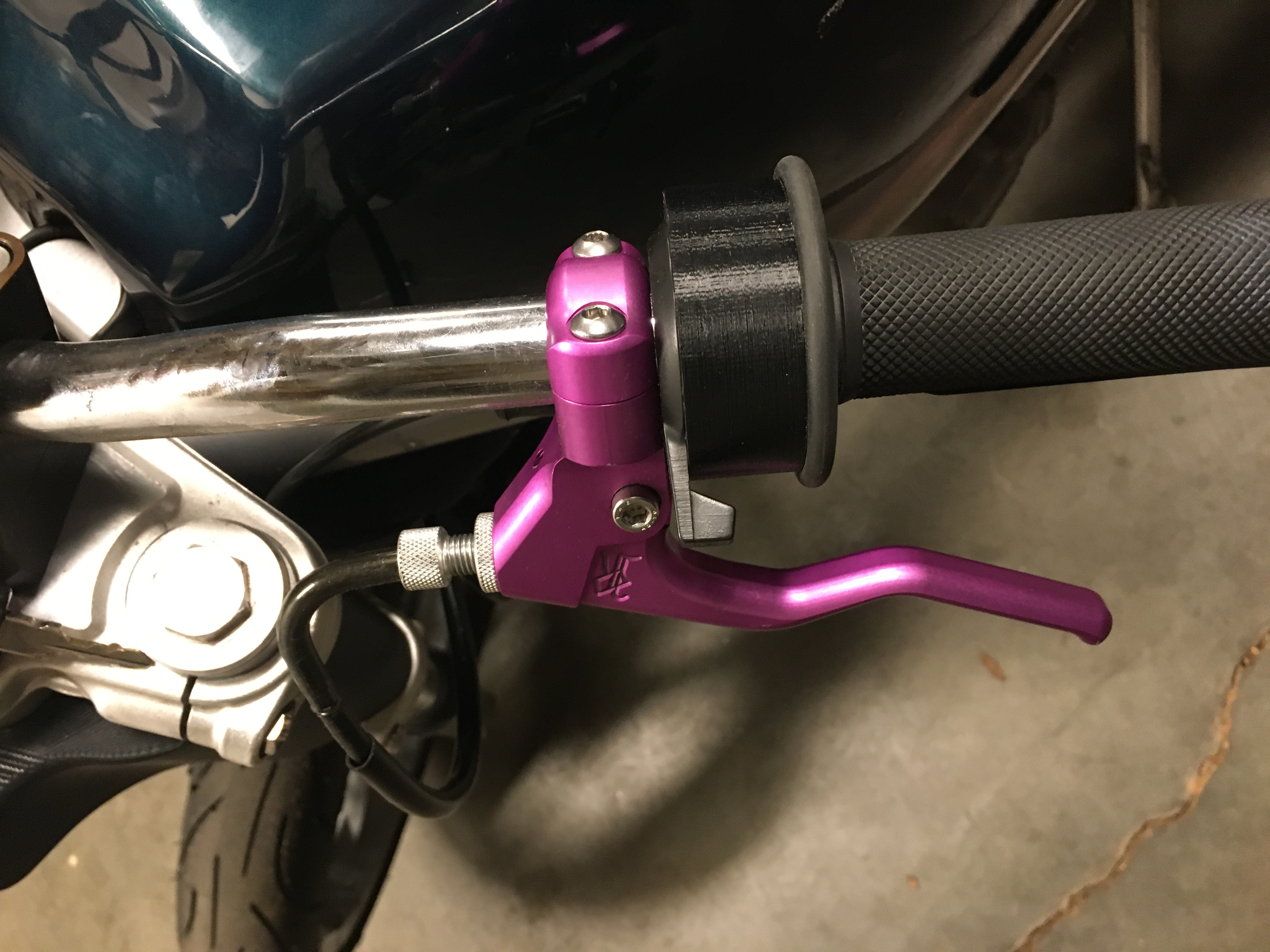

after riding a couple hundred miles the RSC clutch lever is fantastic and will stay. It will be de-anodized and silver when the solution comes in to do so. But, with the changes leverage ratio the clutch pull is so light and nice. Still can get full engagement and disengagement.

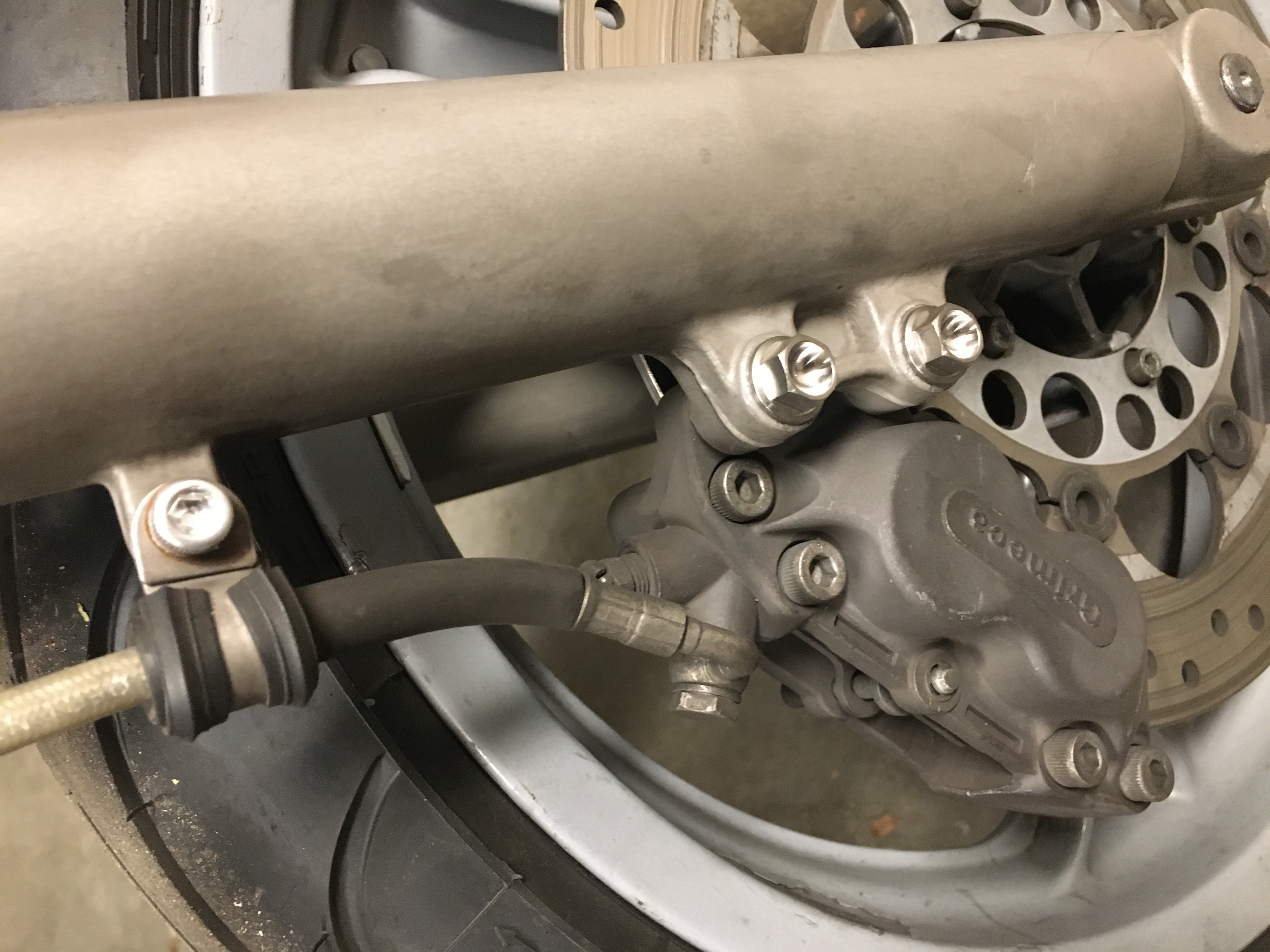

Some of the titanium is starting to drift in as well: some brake bolts, a steering stem nut, etc.

Postby DAVID THOMPSON » Tue May 05, 2020 1:15 pm
need a device to make the cable pull further your not getting a full pull on the cable..
that lever needs to be straight so it can pull more cable

Postby jpmsteadi » Wed May 06, 2020 10:42 am
DAVID THOMPSON wrote:need a device to make the cable pull further your not getting a full pull on the cable..
David, which cable are you referencing?

Postby DAVID THOMPSON » Wed May 06, 2020 3:45 pm
the clutch cable attached to that lever with the bend in it that hits the handle bar before
the clutch releases

Postby Puffs » Thu May 07, 2020 2:10 am
That bend probably fits the rest of that outfit & is not likely a problem. Levers bent like that are quite common, as are shortened levers in offroad.

Postby jpmsteadi » Sun May 10, 2020 3:18 pm
DAVID THOMPSON wrote:the clutch cable attached to that lever with the bend in it that hits the handle bar before
the clutch releases
David,
The clutch releases perfectly. No issues with anything hitting.

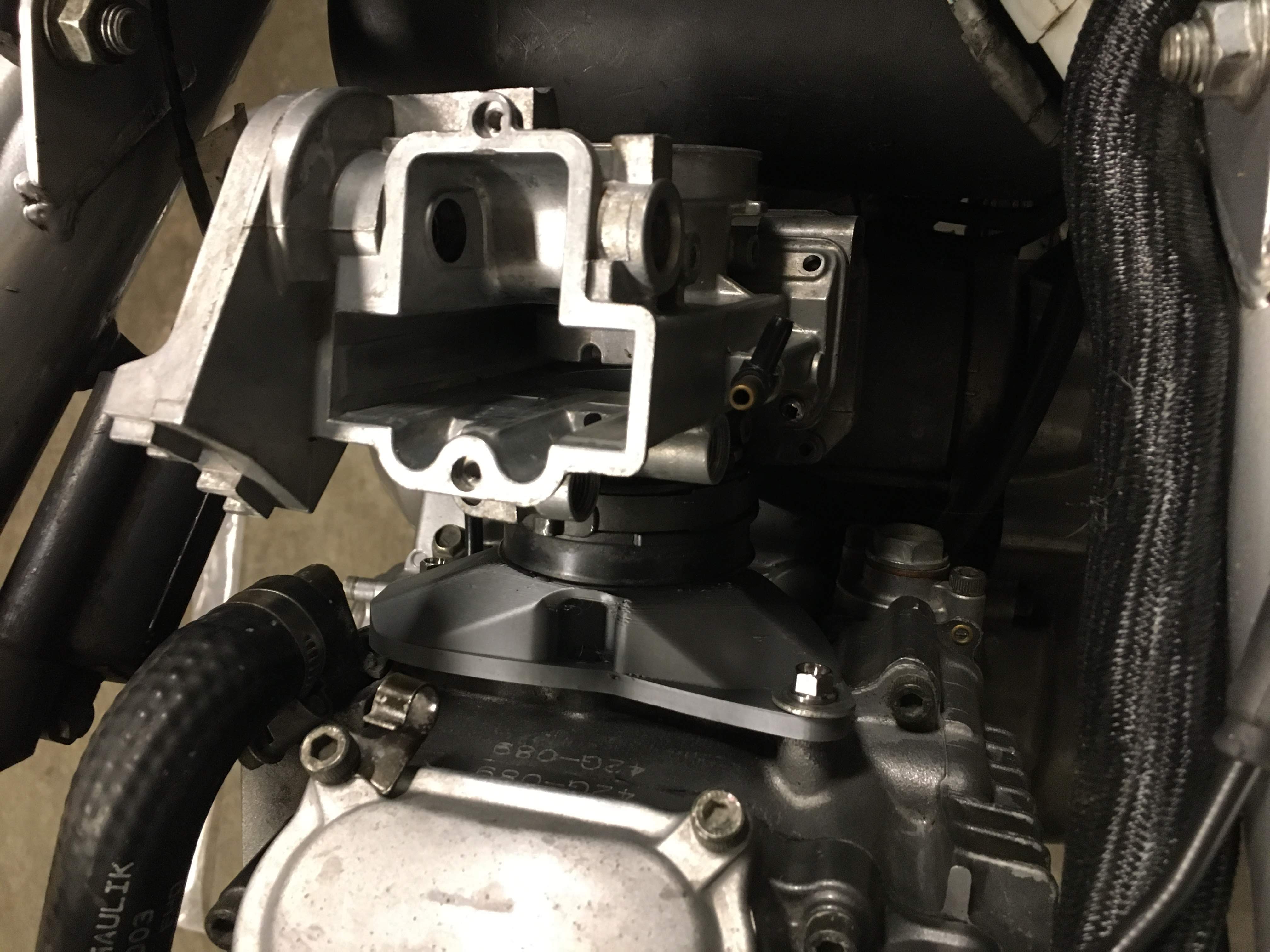

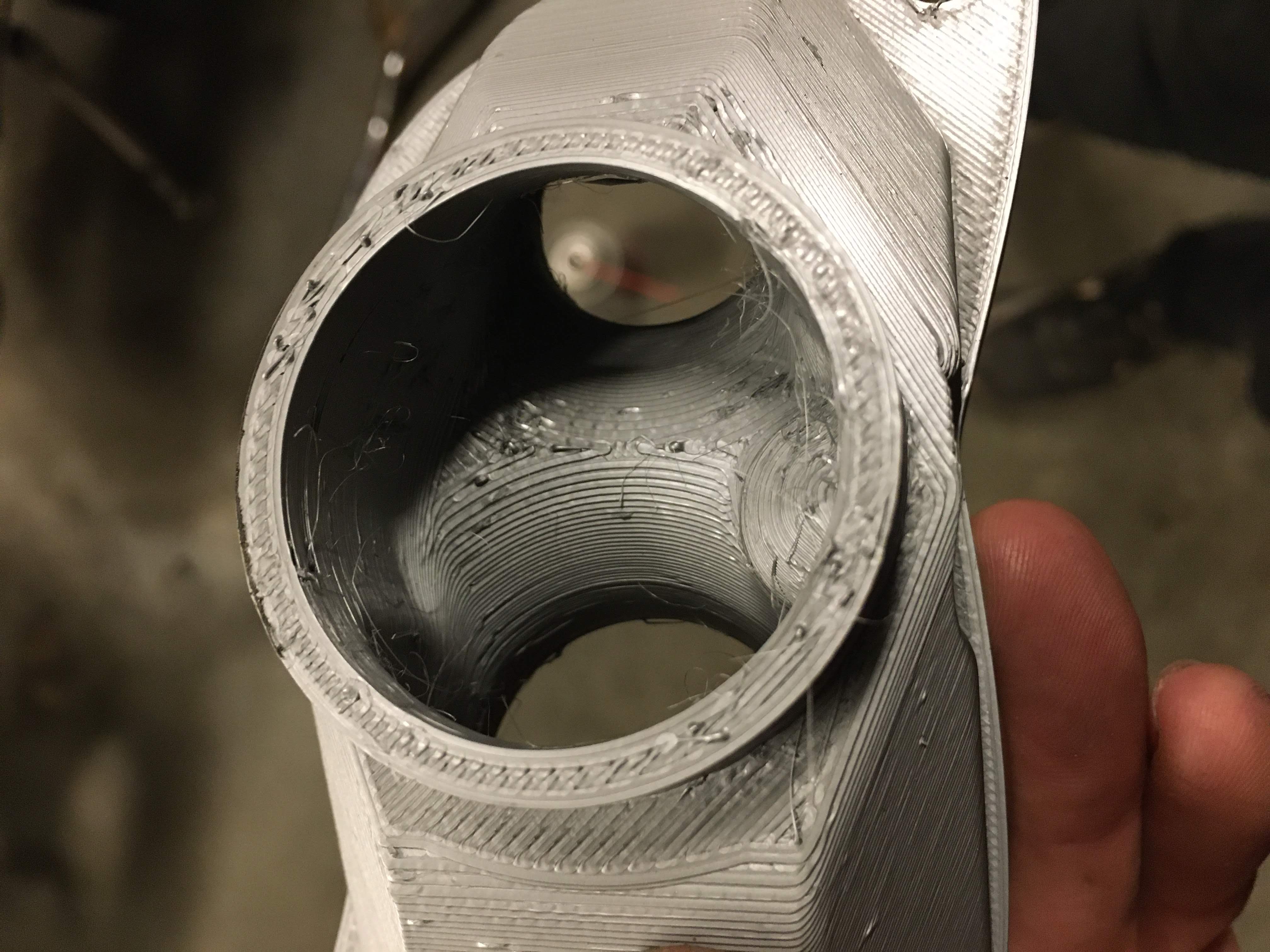

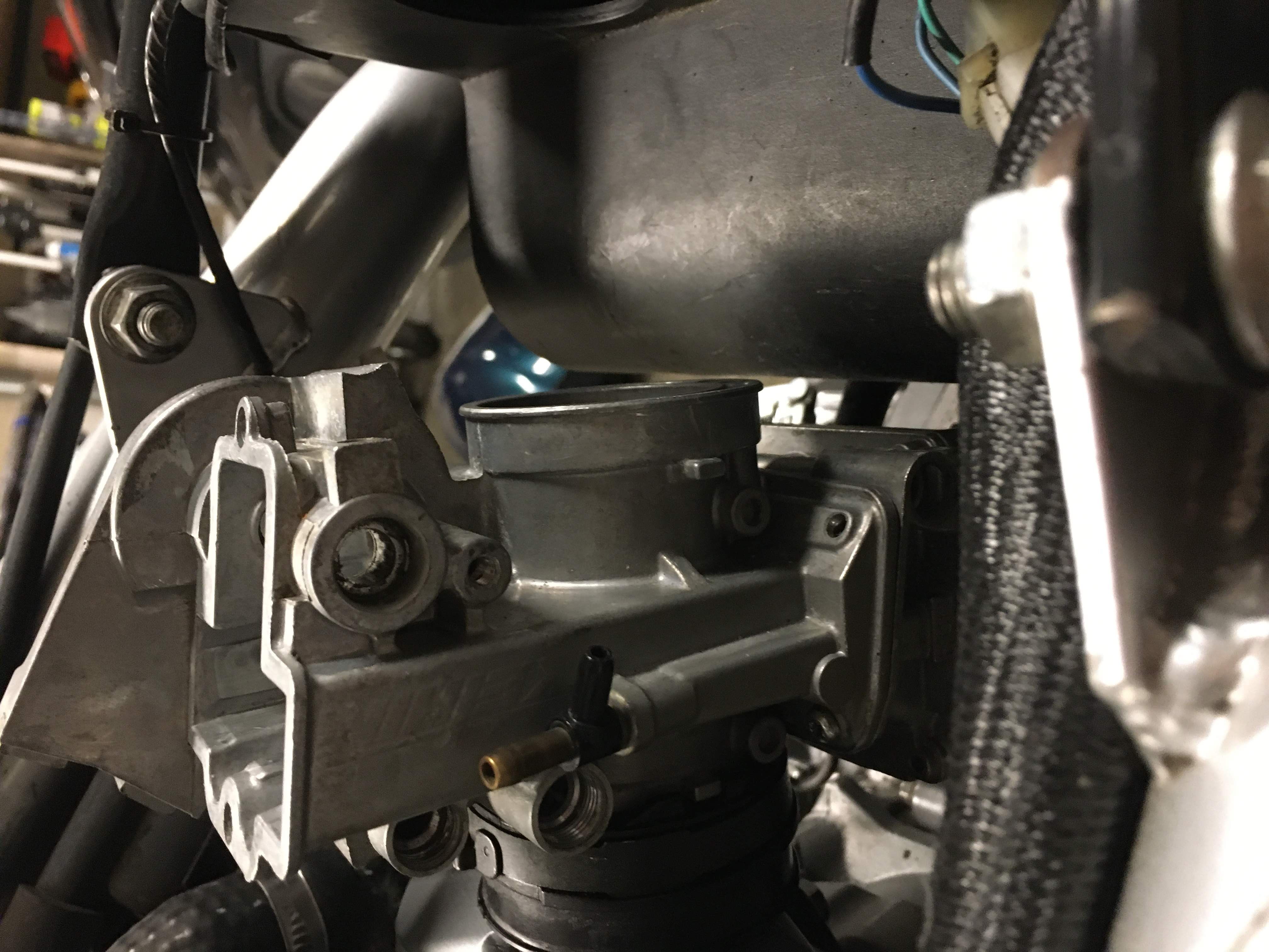

I got in the FCR carb on monday. Unfortunately it was in much worse shape that I had anticipated, so I have ordered some replacement seals and parts. Thankfully a friend of mine has an ultrasonic cleaner that I was able to dunk it in for a couple of hours.
I started the process of test fitting and designing an intake manifold in cad. The second one fit pretty well and the carb fits well in the space. I think I can keep the stock airbox too!
This is a view into the intake. Forgive the strings and the steps in the curves; this was printed in the fast settings just as a test.

Postby Puffs » Thu May 14, 2020 4:43 am
On the Svartpilen, I didn't feel cramped, but seating-wise I'd prefer the Vitpilen, with the lower bars. And also the white colour scheme looks better, though of course for both bikes the style remains an acquired taste (which I have yet to acquire). Riding-wise it's OK, though your feet are a bit low & maybe it's a bit heavy its power (161kg dry, 75HP, 72Nm). It that sense the 690 was better (148.5kg dry, 147 for the SM).
On your intake manifold: I should consider to get myself a 3d printer - that looks very desirable! (Is that plastic strong enough to carry the carb & can it withstand the temperature?)
But there is a choice to be made on the design of the manifold. Yes, if you keep the length low enough, you can use the original air box, un-modified (and that is desirable). But it seems that the price you pay is that the gas flow has to make rather sudden changes of direction. Yes you will round that off nicely, but still: that will cost power.
If you were to make the manifold longer, the flow should be better - but then the air box needs to be modified (and probably become smaller). That too is less desirable.
Anyway, that's the choice, IMO. And to test the impact of the different manifold designs is not so easy either, at least not with an air box.

Postby jpmsteadi » Thu May 14, 2020 7:21 am
Puffs wrote:On the Svartpilen, I didn't feel cramped, but seating-wise I'd prefer the Vitpilen, with the lower bars. And also the white colour scheme looks better, though of course for both bikes the style remains an acquired taste (which I have yet to acquire). Riding-wise it's OK, though your feet are a bit low & maybe it's a bit heavy its power (161kg dry, 75HP, 72Nm). It that sense the 690 was better (148.5kg dry, 147 for the SM).
I also have not acquired the taste to enjoy those bikes.
I completely agree on the longer manifold with longer runners. One of the fun parts about 3d printing is being able to make new parts and change them so easily. My goal right now is to see how little stock things I can change, but once I see how it runs I am very tempted to throw out the airbox and make one of those as well, allowing for longer runners. There will be a point at which the runner length is optimal. I agree that currently it seems that the runners are too short and too oblique of an angle for optimized airflow at higher RPMs. That beings said, I may have less airflow anyway at higher RPM full throttle by going to a single carb; I am almost certain that the two smaller carbs have a larger overall opening than one carb. So, if I gain some low end power through intake velocity with the new carb and slightly restrictive intake, I might be willing to make that trade. But honestly in this situation I only know enough to be dangerous.
As for the plastic, these test fit pieces are being printed in PLA which absolutely does not have the strength or temp resistance, but for the final (ish) print I am going to be using Nylon, which should do nicely in this application. if the part works really well and there are other people who are interested in doing this conversion I may do a CNC run of the part. Not really cost effective for a one off, but if you get 5-10 parts made its not too bad really. A friend of mine is doing a similar lightweight street bike build but with a late 80s honda hawk and has used a machine shop to do some adapter brackets for a different front brake caliper (ironically basically the same caliper that comes stock on the MZ, just the slightly later brembo model)

I have looked into getting it 3d printed in metal. The online quotes I got were pretty high. I think the nylon will work fine. It is supposed to be able to handle temps up to 160C (320F) and is a very strong, slightly flexible material. Seems ideal for this application. I think having the part in aluminum would be ideal, but I have high hopes the nylon will work.
The engine side of the manifold has two shape matched outlets and two oring grooves to seal it to the head. Other than that its just a flat piece.
