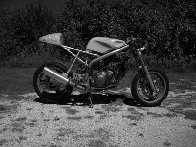

Spare jets are here and I've talked to my suspension guy about building me a shock in the near future. So aside from the outrageously expensive wheels I want to get for this project, and the Brembo calipers, all of my performance related modifications will be complete by end of summer. Man I wished I weighed half of what I do so I could feel the true potential of my little beast. :lol:

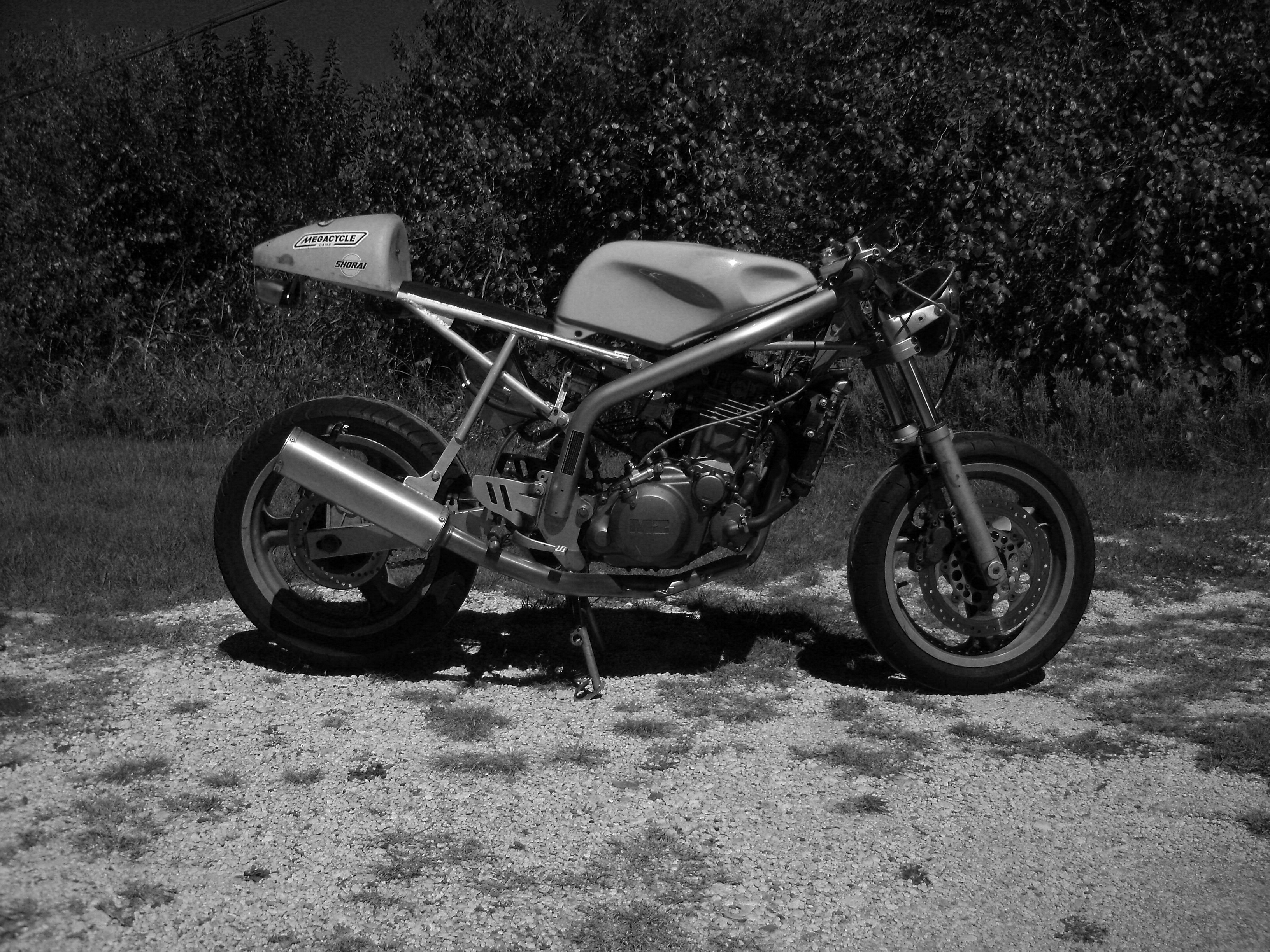

Postby edfmaniac » Tue Nov 10, 2015 10:32 pm
