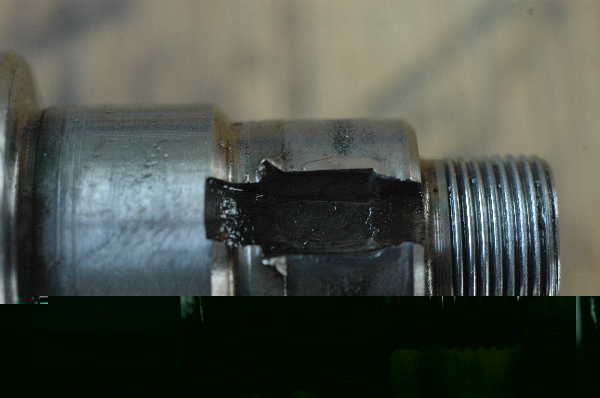

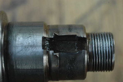

Postby Bill Jurgenson » Tue Jun 29, 2010 1:03 am
here, both gears together;
We are not talking about the gear on the balancershaft, altho I have seen one ruined balancer:
Here, instead the keyway of the balancer is shot beyound repair and just shy of giving out.
This is unusual, tho. After;peening the keyway backdown and removing the weight entirely,I am using this shaft in a balancerless engine.
The gear cost 80£ from Slipstream and yes, I have installed it. I install it in every engine I have to open.

Postby Bill Jurgenson » Wed Jun 30, 2010 5:35 am
you did not read correctly!
first the Slipstream gear is the one on the left without a cushdrive, the other is the OEM item, and
Secondly, I just fit this gear to the SZR from which the eaten up key came.
thirdly, I did not write anything else nor write confusingly.
My Skorpion has the gear as do all the engines I have rebuilt in the last two years.
I also wrote that there is no typical mileage. My Skorpion had slightly over 30tkm. i.e.20000mls and I am aware of others sith such low mileage.
And from what I saw in the SZR last week, the key must have sheared of in that one, too. Since I got that one with 32tkm it was about the same.

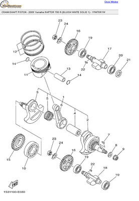

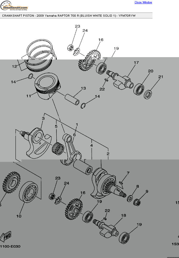

For what it is worth, the similar gear in the Raptor 700 is solid!
may be they did learn something.
Re: Seized 660cc motor : what happened ?
Postby hb7 » Thu Jul 01, 2010 11:47 am
2009-2010 700 Raptor US model still shows springs....
hb7
Posts: 348
Location: Los Angeles
Postby samandkimberly » Thu Jul 01, 2010 8:19 pm
Odd; according to the parts list at Bike Bandit it *is* solid:
The gear goes for $63.71, but the mating gear on the balancer has a different #, so no idea whether it could replace the one with the spring.
Sam
