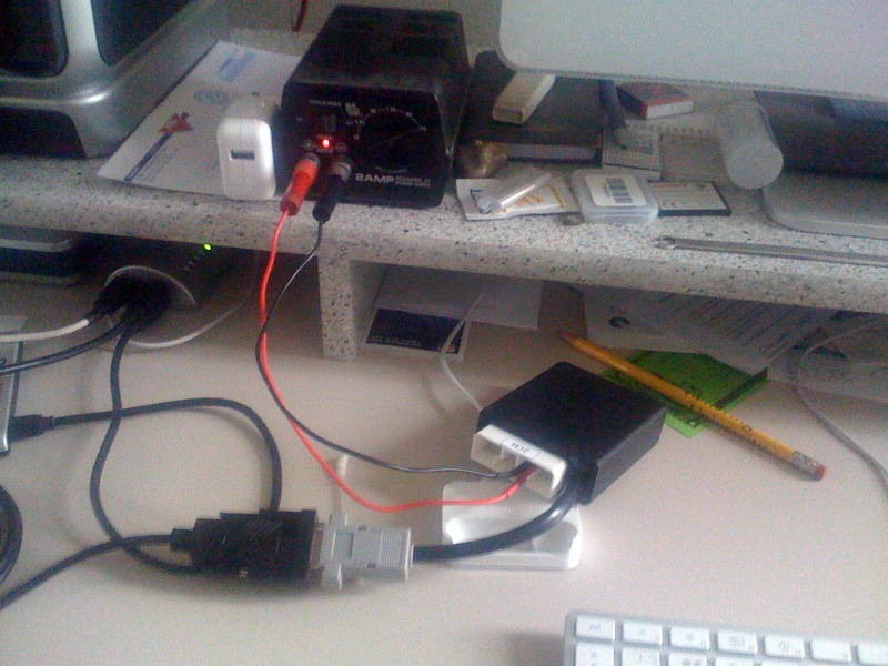

The user needs to have a PC with XP or 7 ( or - igad - Vista) and RS232 interface cable.
This one if the PC still has that serial port
but more probably this kind:
which needs a driver under Windoze
the Box needs to be under power, i.e. either installed and the ignition turned on or, at the desk,with a 12v battery or DC power supply to the two pins 13 & 14.
http://www.ignitech.cz/english/tcip/manual_sparker_tcip4_v80_en.pdf
This is with a Mac OSX and XP running with bootcamp.
I normally use a little ASUS netbook running XP, either at the bike (e.g.when I ride to meetings) or at the desk with the powersupply which is what I do with new boxes when I get them.
