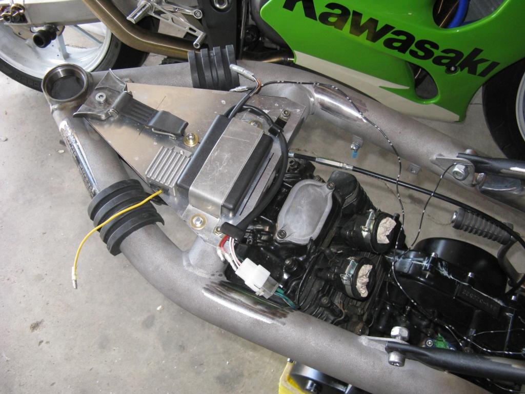

Starting to work on the wiring. Want to get it in a convenient location, so under the fuel tank seems to be a good spot. Can access everything by flipping up the mito tank.
The aluminum plate may one day be replaced by carbon... although perhaps not! ECU is new from Belgium, coil is mounted to the underside. It will be grounded to the steel frame tube, not "just" the aluminum plate.
Swingarm was powder-coated now, to test the waters with a new coater in town. Not bad, although a tad pricey. Just need to press in new needle bearings (on order) and it can go in the frame.
Once everything is up and running (perfectly, of course, with no issues, hiccups, or problems(!), I'll powdercoat the frame.
