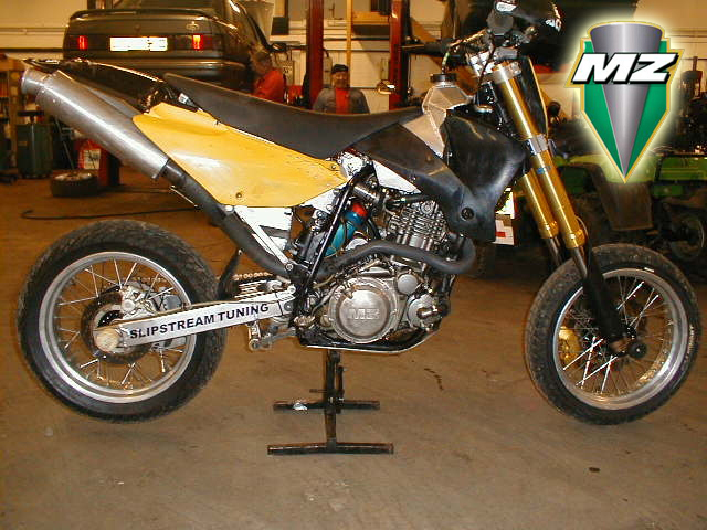

Harold,
Thought of this picture posted some time ago.
OMC

OMC,
Now that is what I call, highly modified, from one end to the other. By the way, if you want to see some negative ads right now, just come to Florida. Every other commercial on TV.

Postby basser23 » Mon Jan 30, 2012 12:09 pm
that is Wonky's bike in progress a few years back. Know as "STMZ" highly modified,as Wonky used to work at Splistream Tuning.
A true monster machine...MCN tested it years back...
