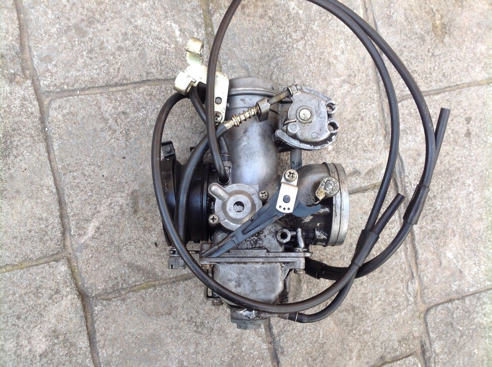

Went out for my first ride today after some long overdue work on the chassis.
Wirth progressive fork springs fitted with original spacers, forks flushed out and 700cc of 10W oil in each.
Bar risers removed (back to original) forks raised into yolks about 20mm (Until they hit the underside of the bars!)
Stripped out rear linkage( all good) and fitted lowering links, dropped back end approx 40mm, and made the rear suspension more comfortable as expected (shit roads around here) :roll:
The brakes had a full strip down and "refresh"
Not surprisingly it now feels a lot more positive and agile and fun to `point and squirt` on the twisty stuff despite being about due for a new front tyre! Well worth the effort!
Lets get those carbs off(Again!) and dig out that old end can and link pipe out the garage! :D
