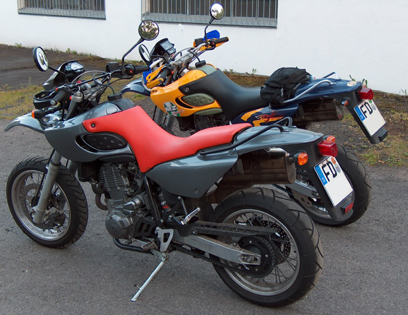

So... I can buy this 2003 (6700km) with home-made panels mixed with what looks like the unpainted black, with the left tank panel and mount bar available (the attached picture), or a new yellow one for 49% more or new silver one for 51% more. If I get the used one I'll probably want to buy the panels ... cost would depend on the colour, or the unpainted black and get them painted - preferably like this grey one: ...shipping costs...[thinking aloud here]...the painted ones are not going to be more expensive than getting a good paint job done. So... hmmm.. :?

Postby keithcross » Fri Dec 02, 2005 3:54 pm
I quite like the look of the panels on the first picture, kinda like the effect that I want. Just wont cut down my original panels until I get spare ones.
Keith
Ride it like you stole it
keithcross
Posts: 922
Location: Hampshire England
Postby cat » Fri Dec 02, 2005 3:59 pm
keithcross wrote:I quite like the look of the panels on the first picture, kinda like the effect that I want. Just wont cut down my original panels until I get spare ones.
Keith
No. You can see in the photo - the front edge - they're not cut down, they're specially made. You'd need to make a mold from yours, and reshape the mold to get the front edge the way you want. But I don't know much about it. You could probably use surfboard type foam/mold stuff to take a mold from your stock ones, with silicone spray to stop it sticking.

Postby keithcross » Fri Dec 02, 2005 5:10 pm
I might be tempted to try that, might just work. You rpiture was usefull as it shows how to get the front bottom mount.
