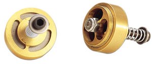

Postby omrra91 » Sat Aug 04, 2007 3:22 pm
I'm glad to hear people on the board talking about Race Tech parts. During the construction of my MZR road racer (see other post)I ended up with some spares. I don't know much about the Race Tech goodies, but here is what I have. A set of Cartridge Emulators in excellent condition. They came out of my 41mm TZR forks so I figure that with the correct length spacer and possibly different springs they will be a great improvement over the stock fork set up.
Regards, Jeffrey
