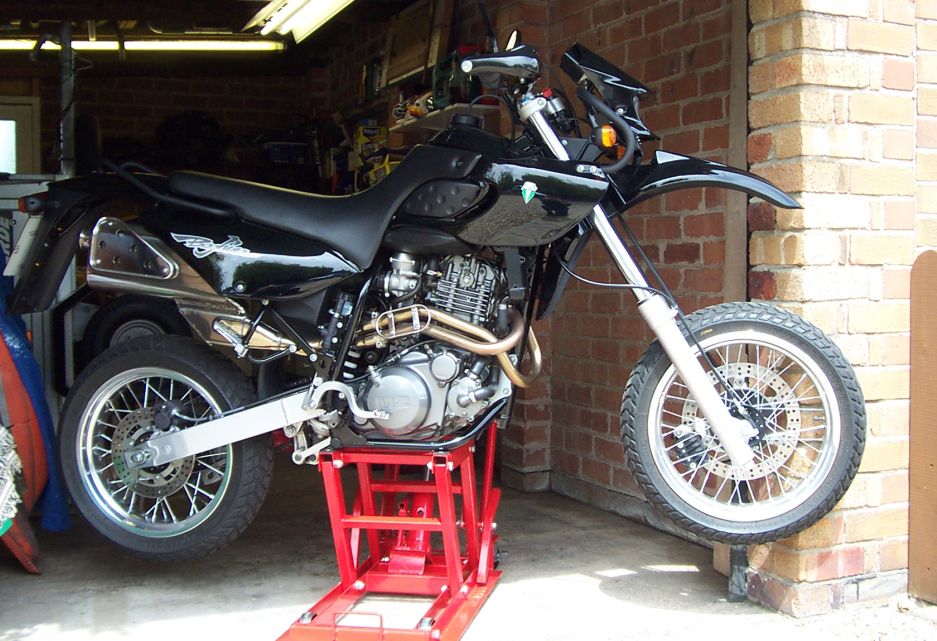

Postby street_moto » Thu May 04, 2006 3:32 am
No main stand on the Black Panther, but I bought this stand off Ebay, £79 delivered, lifts to a decent height, both wheels off ground and you can manouvre the bike once lifted because it has wheels. It's steady enough to work on, but any tight nuts are loosened off before lifting, hope this helps. :wink:

Postby DAVID THOMPSON » Thu May 04, 2006 9:59 am
i have a stand that looks the same in black and it works fine
but had to make a wood frame to fit it to bottom of both the
rt125 and saxon tour as they are not stable if just lifted with it
with out an adaptor :D
