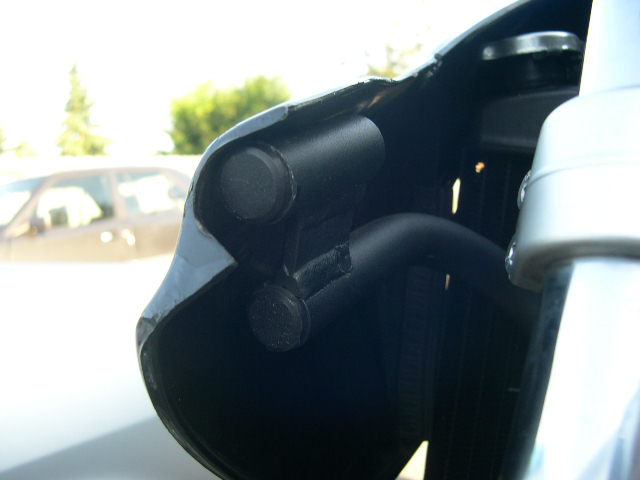

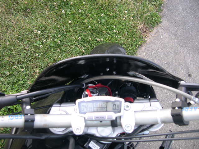

the first thing i did was to cut the loop bars off of the front of mine. I cut the bar that comes from the radiator to the side panel flush with the front edge of the side panel. and installed the small black push in cover into the end. I then removed all the headlamp/ speedo stuff and ran an Acerbis headlamp fastened to the forks with the supplied rubber straps. worked great, except no room for stock speedo. ran a Trailtech on the handlebars, ran it that way for 2 years. just recently went back to stock headlamp/speedo/front fender to change it up a bit....

thanks for pictures. I did think of cutting the original frame like yours, but wanted to retain original parts in case i sell bike and need to put it back stock so may try and source 2nd hand frame and cut that or make my own brackets. like the speedo but will stick to my original for now . I will send pic's of my rear as soon as i can. Thanks For now

better to keep the original, but these frame tubes, you could always get the cut off pieces welded on again nicely and sprayed with wrinkle black. i'll go ahead and cut my tail piece, but i want to try to get a subframe. i won't get one here, though, that's for sure.

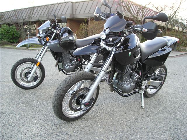

pics for you guys out there front end to be sorted..

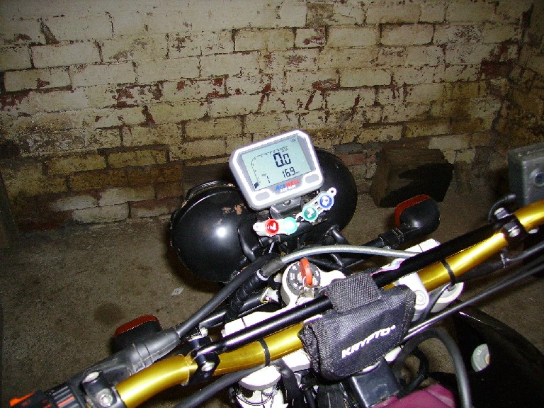

Here are some pics of my speedo/ rev counter and of my cut down rad shrouds.
The speedo computer is an Acewell unit I got from Banditmania here in the UK. It shows speed, rpm, max speed, max rpm, odo & 2 trip counters (I think). You can also get them with built in idiot lights for more money (I think Keithcross has one of these).

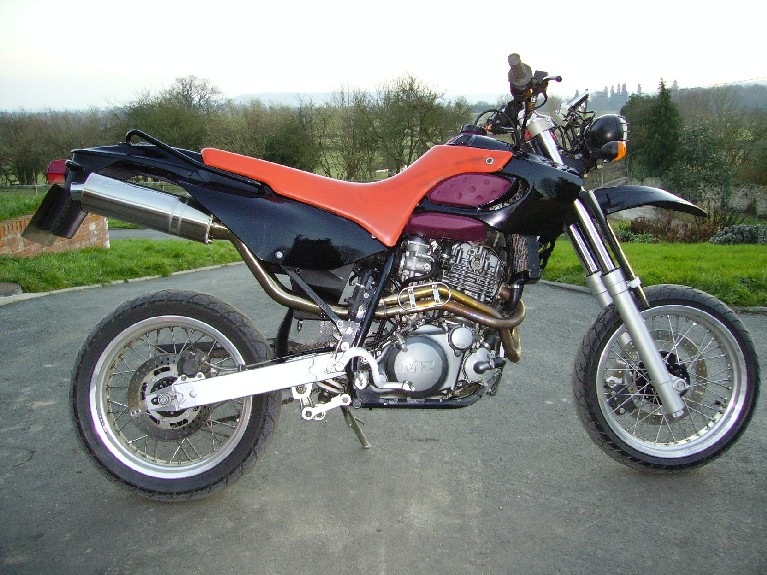

I know you don't want to chop up your bike, but by cutting down the plastic rad shrouds I was able to completely remove metal loops from the front of the bike without cutting any metalwork, and improve the looks too (IMO :D ). The pic of the bike from the side shows what the cut down shrouds look like.
Hope that helps!
