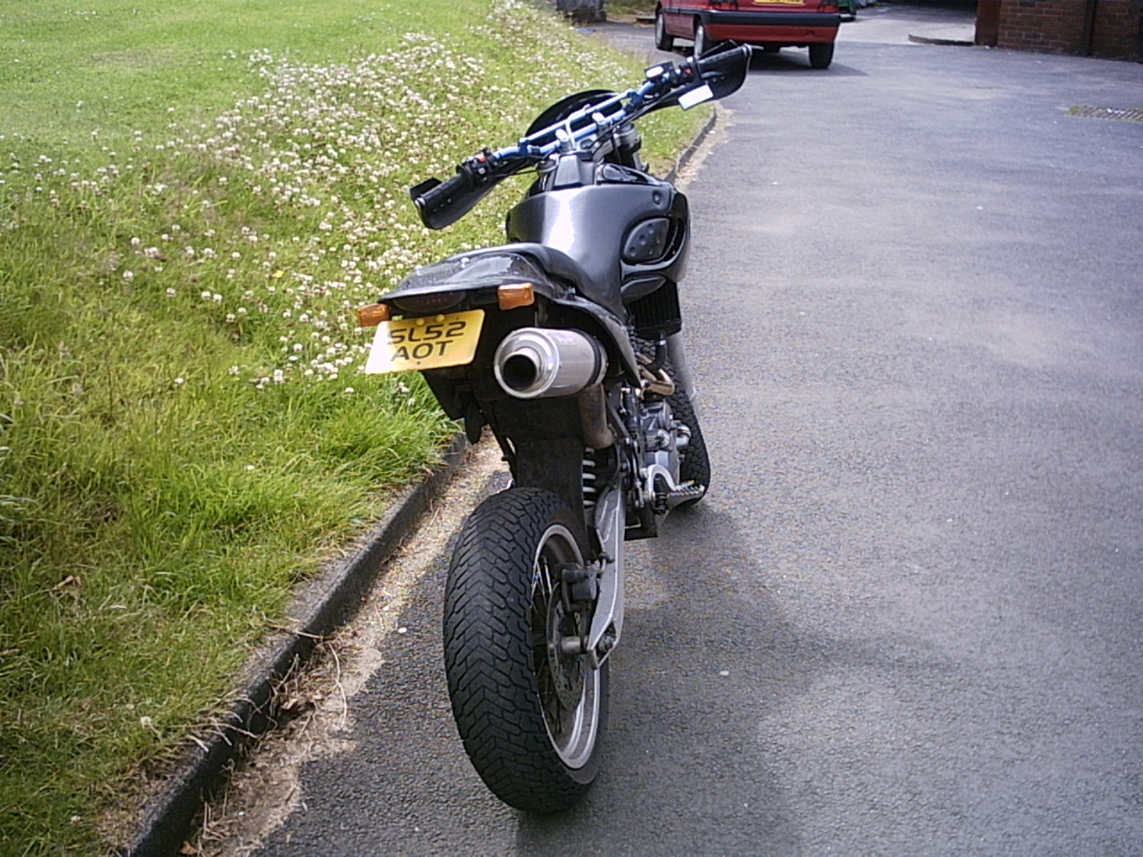

If it works you should find a picture of my Baggie with its new back end. I have dumped the long plastic fender and made a short one from Aluminium and added a small LED instead of the ugly original. Hope the pic loads asI'm a bit of a technophobe..

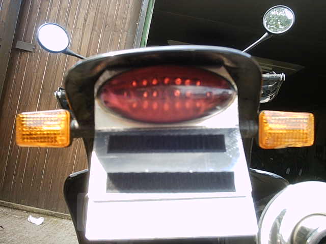

here is another modified back end done by cutting the subframe and mounting an led light that also does the brake light on a aluminium plate that also holds the number plate and the indicaters

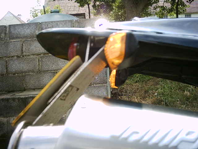

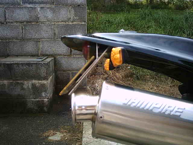

the whole bit that holds the plate, light and the indicators is some aluminium sheet thats bent and folded to the right shape and fixed to the two allen screws that hold the original grab rails at the back lus the sub frame is cut back a bit . i'll take a few close up pics to show how its done . its a good mod as it removes that massive bit of plastic that was there before

the part that was removed from the subframe was the metal loop that supports the large plastic mudguard and it was removed as the new plate was not big enough to cover it up

here are some better pics of the mod
