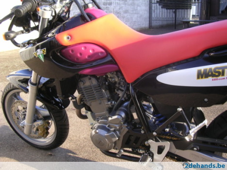

But this is not why I writing this for, I was just checking a second hand site here in Belgium and found a Mastiff with 0km om the clocks and it has Brembo Brakes!!
Does anybody know if MZ made Mastiff's with Brembo brakes? You can see on the picture it surely has a brembo in the front and not a grimeca. Strange...

I think you will find that's the new "revised" version of the MZ Mastiff. They changed the colour and a couple of parts for the "new" versions i think...

that Mastiff has been fitted with 3spoke alloy wheels, and so removing the clearence issues we have with spokes/brake calipers. One way I think we can over come this problem is I once said at a bike show that I had fitted a R1 disk to the front to a EBC brake man, who after a check of his records said that there is a 320mm disk that has the same bolt pattern

R6 or R1 Disks are the same and the bolt pattern is exactly the same as MZ Baggy or Stiffy! :D I think you will find that the above Mastiff has indeed been modified for some strange reason! Looked into it and i can't find anywhere that sells an MZ like that!

The mastiff was available with cast alloy Grimeca wheels as a factory option. With this option you also got the 4 pot Brembo although the rear sadly remained a Grimreaper.

What Garf says is true. I fitted skorpion wheels to my Baghira, then ordered the caliper bracket for a mastiff with mag wheels (the part # is in the catalog) then bought a used brembo caliper off ebay for $40 and I was up and going. Much better braking than with the Grimecas.
