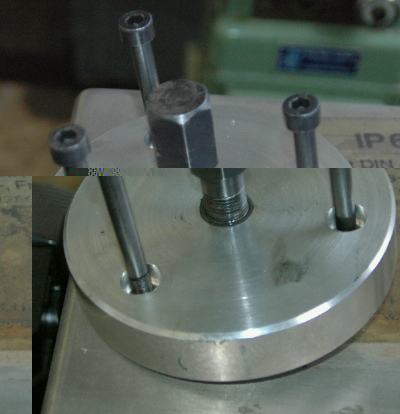

The protector is just a cup turned from a piece of steel rod, drilled out to pass over the threading and reach to just short of the shoulder, outside diameter slightly smaller than the crank itself behind the threading - the part must pass thru the flywheel - and with a center for the wheel puller on the end.
I'll make a photo or two an take the exact measurements this morning; it is so long since I made it I don't remember. Once you have removed the nut from the flywheel end, you can take your own measurements, of course.
For the wheel puller, if you cannot borrow from your favorite shop, or do this:
in the flywheel you can see 6 holes for 8mm screws, three with the bolts holding the freewheel to the flywheel, and three that are threaded.
Measure this pattern, i.e. the diameter of this circle. Take a cut of of round steel as large as the flywheel at least 1/2" thick, mark the center and then scribe that measured diameter around that center, using the radius to construct the hexagon the way you learned in junior high. Center punch those three holes and the center and drill those three holes slightly larger than 8mm. Drill and tap the center to accept a large diameter with fine thread. NF or metric fine, it doesn't matter; tap to fit the bolt available, but it should be at least 1/2". The easiest way is to buy one such as this M16x1,5 (I use one like this)
http://www.sportingforless.com/flywheel-puller-kawasak-yamaha-xj650-suzuki-gs550-p-120.html?cPath=43
or cop the bolt from another wheel puller. This job is beyond the means of most household shops, but it should be easily possible to find a machinist to do it.
el cheapo wheel pullers are not up to the job, believe me, and top-quality pro tools or OEM Yamaha tools are very expensive. I have seen my share of bent and twisted one-size-fits-all wheel pullers - that f---in flywheel still wouldn't budge.

Postby Bill Jurgenson » Tue Jan 22, 2008 5:16 am
Yes, that sort of thing, altho I do not like the one-size-fits-all kind at all. It doesn't cost much, however, so it might be worth a try.
the protector for the crank is 29mm long, and 20mm Ø, drilled 14mmØ inside 23mm deep.
I have also attached a photo of my wheel puller. It is of highest grade aircraft aluminum and 30mm thick.
Once to have the case apart, you can see how extensive the damage is. To weld what I can see, you'll need to steam clean the case side as it must be oil free to weld. If that is all there is to weld, it is worth the effort, but you'll also need someone to mill the bearing seat from the inside once it is welded. No big deal and it is not rocket science.
So once apart and clean check out both the welder and the machine shop for pricing - and competence.
