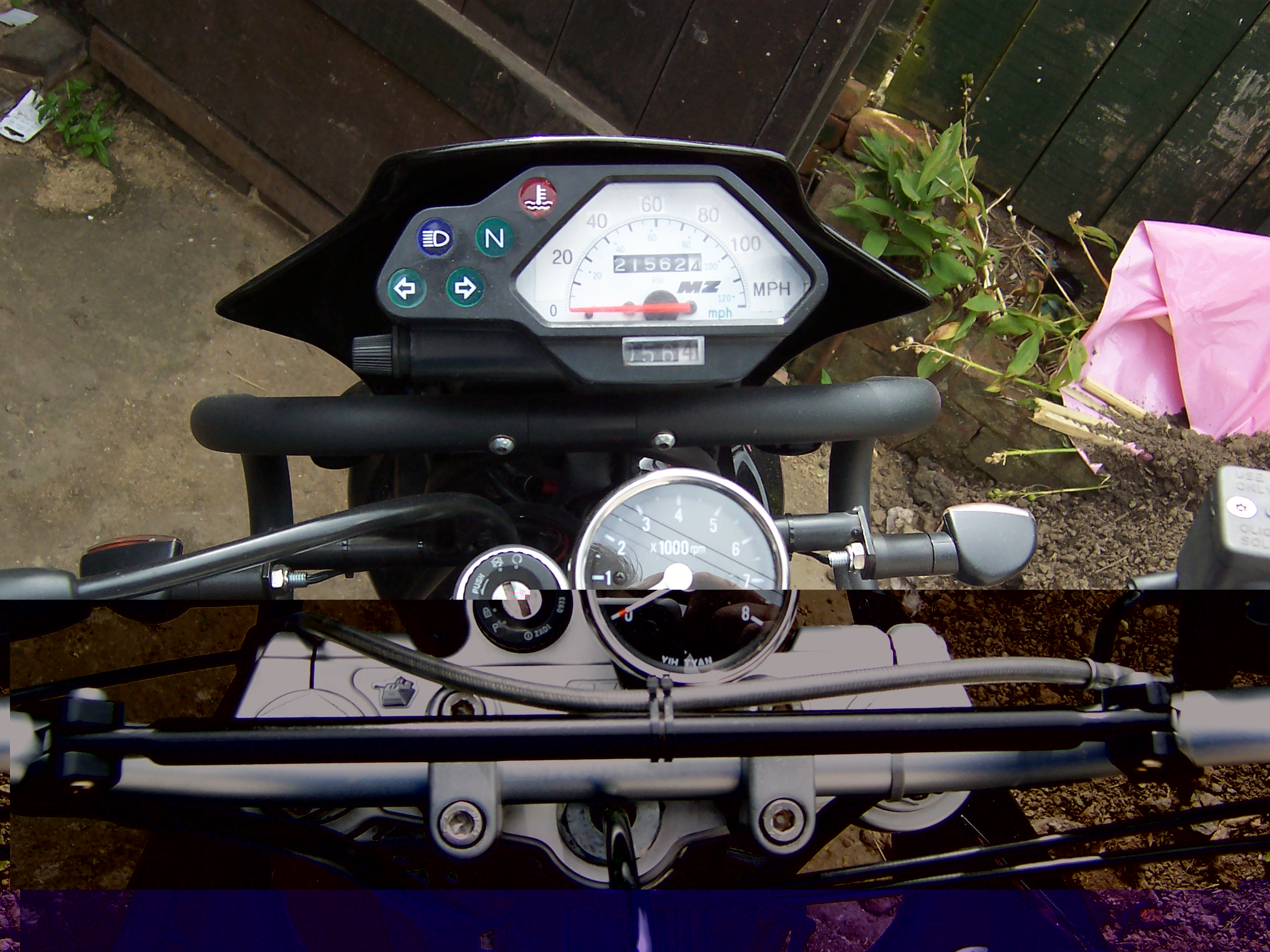

Hi,
I purchased 1 from M and P for my Baghira, it took a bit of doing but after a few phone calls to M+P and their supplier i eventually got one. I mounted it onto the top yolk and connected up 4 wires and away it went with no problems. I you are ordering one make sure you ask for one that has a 60mm black face, goes from 0-8000 rpm has a chrome body and is compatible with a single cylinder engine, if they say that they dont do one then tell them that they do and to look a little bit harder. If you are getting no joy then let me know and i will give you my name and then they should be able to source it from my last order.
Kenny.

Postby Wonkmeister » Sun Feb 17, 2008 12:48 pm
Garf wrote:Oh yeah, and slipstream sell 'em. Sorry Wonky I forgot that you had set up a supply when you were building the STMZ.
Is she completely finished yet with your motor and carb installed yet ?
You have been so quiet I was beginning to think you had taken your fat wallet and moved to Mexico :)
Cheers
Garf
LMAO...hey mate. I've actually sold my STMZ to my best mate...flash git sits it next to his 1975 Porsche 930...looks awesome...i'm happy she's still in the family so-to-speak. Shes all back together in basking in her glory....
I've started the 2008 Baggy project....powdercoated frame and same forks as Whysub....looking good! Aint heard from you for ages dude, glad your on the mend dude! :-D

Postby Wonkmeister » Sun Feb 17, 2008 12:51 pm
kendo wrote:Hi,
Kenny.
The Acewll digital units have a rev counter feed that goes directly to the CDI unit, funny thing is the CDI has one tab not being used on the Baggy and this is the feed to the digital unit that gives you an accurate rpm reading! Cheap too....
