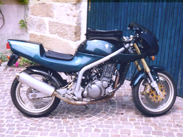

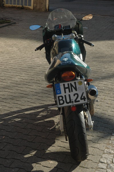

Postby Bill Jurgenson » Wed Mar 05, 2008 2:20 pm
I cut them away first thing, right from the word go! Didn't use those truck mirrors, tho. hier 9is a picture of the beast in "original" condition before I turned it into my racer.
Now ist is back to something approaching street legal, as above without the stays and without the lower extensions of the stays either.
