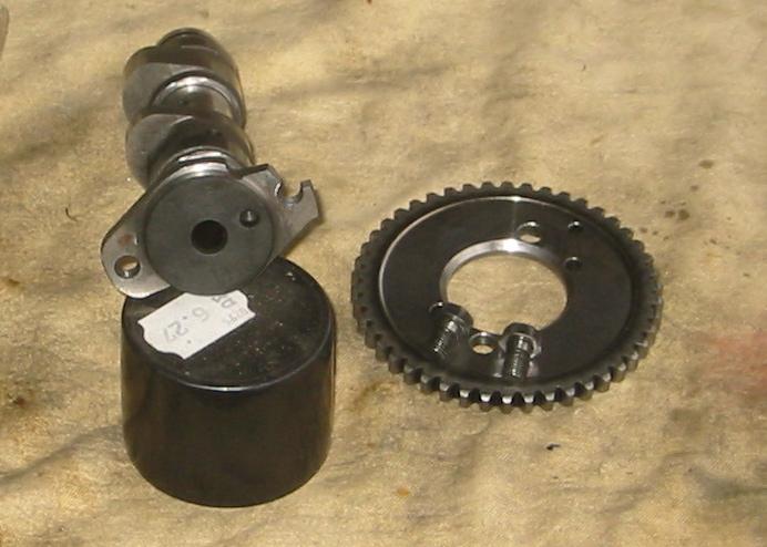

Cams only from Megacycle
NOT a Megacycle!

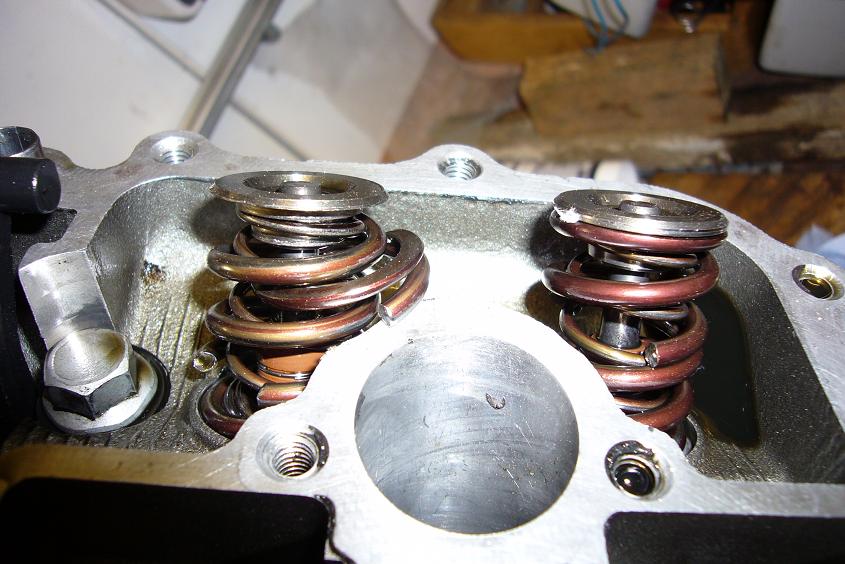

springs only from Kibblewhite or RD
this is what happens with "noname" "racing" springs.
And while we are looking at this photo, the Ti retainers are worthless. You can see that the valve stems are not recessed; they are just as in the stock setup. Racing springs are harder, on the contrary, they are for more lift and must be longer the retainers are recessed, to accommodate for the longer springs.
These springs actually blocked up with the noname "racing cam" the owner had installed, supposedly a stage 2 but with even more lift than a Megac. stage 4.
Both parts probably "Hotcam" but the dealer he got the junk from wouldn't divulge. Money down the drain.
In another similar case with "racing" parts
The springs didn't break, the top of the valve tore off due to the springs blocking.
