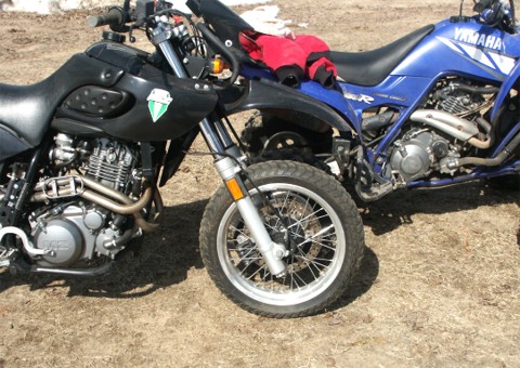

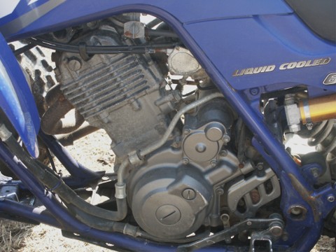

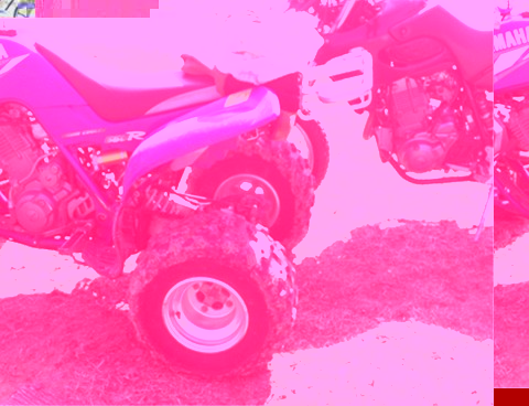

In a side-by-side comparison of a raptor motor and an MZ motor there are differences that become apparent. The outer cases are similar but different. The cylinder in the raptor is noticeably canted forward. The head and cylinder appear to be the same. I hope these photos help with anyone needing to make a comparison.

The 5 valve engines are basically identical. the angle of installation is irrelevant.
What is different:
-the right side covers are different and they are not interchangable. Too bad, too, since the spin-on oil filter of the Raptor is definitely an improvement. This can probably be seen as catering to the US market.
-the crankshaft. The left crankstub has a different taper. The generator rotor used in the raptor is different, smaller. The cranks are interchangable however and the porkchop style crank of the Raptor runs just fine in the XTZ engine. You need the rotor to go with it and, easiest, the left sidecover including generator and starter as well.
-the carb. Te Raptor has a dual CV carb, not the register carb you are familar with. It will work with the XTZ engine of course as well and vice versa.
-CDI. The Raptor has a different ignition. Both ignitions work with both engines as long as they are transplanted entirely.
Otherwise, there are no differences.
The new 4 valve engine is a whole other kettle of fish. The mounting points are the same however.

Thanks for the pictures Fred,
I bought a Raptor 5 valve 102mm piston and cometic gasket set. The vendor assured me they'll fit.
Thanks for posting the info.
