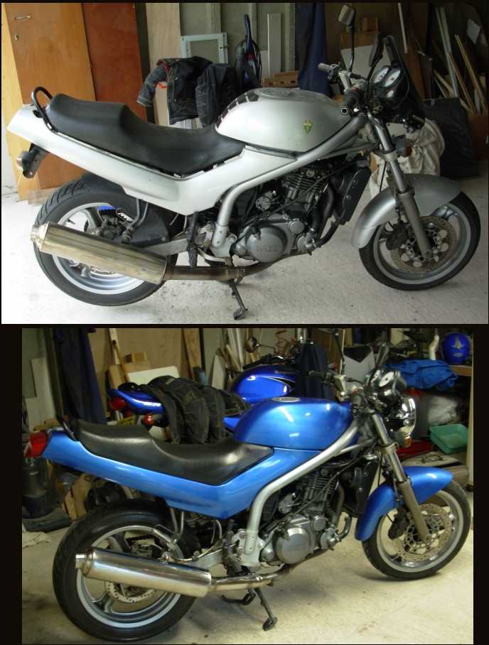

Hi Gents,
Just joined the system as I recently picked up a very tatty Skorpion Tour which I've been respraying and nursing back to health (been after one of these for some years). :D

Postby iceman » Fri Jun 13, 2008 6:57 pm
Welcome,i can,t help with the oil change.
I just wanted to say how nice the spray job looks to have come out,what year is your tour ?

Postby Linegeist » Sat Jun 14, 2008 3:29 am
iceman wrote:Welcome,i can,t help with the oil change.
Hi Iceman - Thank you for the compliment. She still needs a good cutting back and a polish yet but she's getting there. :)
The bike's a 1995 model. She's a had a tough life by the looks of her - and a few butchers have been at her along the way, judging by the rounded-off nuts and the hordes of little bodged repairs. I felt sorry for the bike when I saw her - I could have bought a couple of much nicer examples - but then where's the fun in that? ;-)
