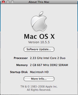

All of my mainframes, The computer I use at the desk which also serves as the server for the house, have run and run now 24/7 and not one fan has died.
Way back when, the fans ran a lot and lots of them with the UPS, too, including the one exhausting the server cabinet(220v.)
ancient history, tho since I now run a dual core iMac right on the desk.
Picture 2.jpg (27.49 KiB) Viewed 2614 times
THe UPS gone, I keep Printer paper and blank CDs/DVDs in the server cabinet now and the fan of iMac almost never runs. Took awhile to get used to the unearthly still in the office.
