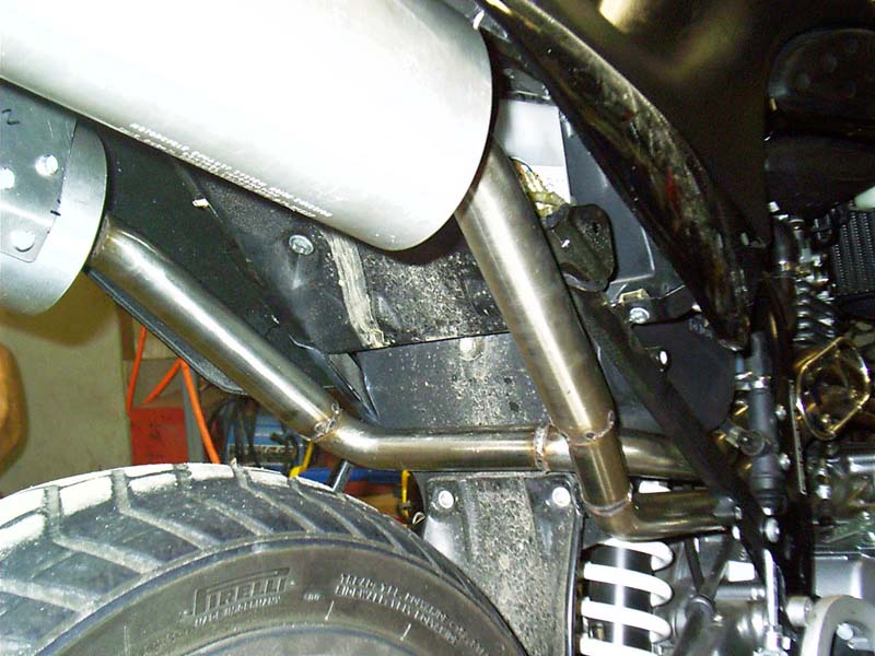

Postby phlat65 » Mon Oct 04, 2004 8:22 pm

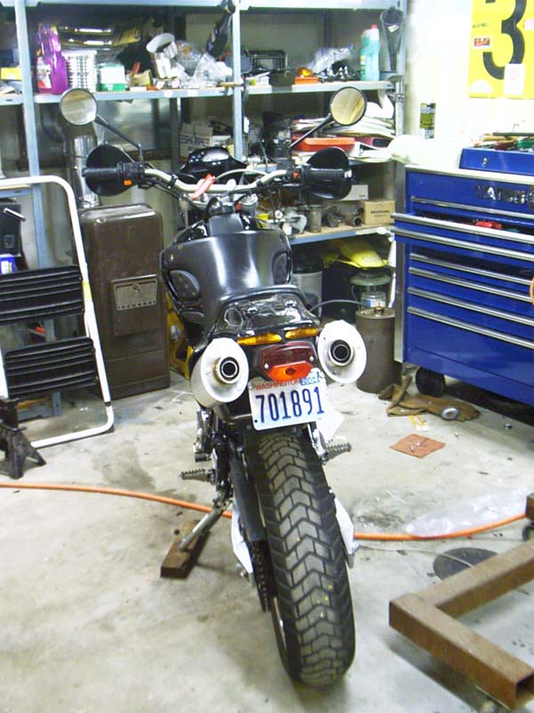

I have made 2 complete exhaust systems. A single can competition system using a stock 02 YZF450 can, cut the stock Baggy head pipe and welded to the YZF can, mount lined up perfect with the stock location, and tucked real nice in the side panel. It is LOUD!!!! (looked for some pics, will take some tomorrow)
2nd system uses stock Ducati 748/996 cans with custom head pipes. I made the head pipes out of stainless bathroom grab rail from hardware store, made the can mounts out of alluminum and riveted to can, and mimicked the mount location on the left of of the right. it is a little louder than stock, breathes really well, and has a little bark when you go to WOT.
seat of the pants has the quiet system with better tourqe, wheelies easier, but the loud system maybe pulls better on top. I prefer the twin pipes.
system 1 cost me $0.00
system 2 cost me $95.00
here are the pics

Postby phlat65 » Mon Oct 04, 2004 10:24 pm
thanks for the props guys!! I love to make things, even though I am not the greatest fabricator.
welding stainless is not so hard, bought the correct wire for the wire feed, and went at it.
I did not do a 2-1-2, they are not tied together at all, That is next, but I dont think it will help that much, since both cans flow so little.
I am going to add an oxygen sensor bung to 1 of them, and record runs with my lab scope at diff throttle settings for jetting purposes to get the most from them.
they probably weigh the same as a stock exhaust. feel about the same.
as far as rubbing, I removed the rear shock and swept the wheel through full travell before I built the mounts ( they are also supported at the end with a Mercedes Benz air cleaner housing rubber mount)

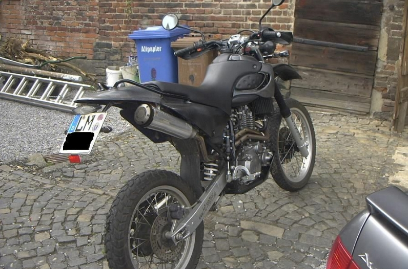

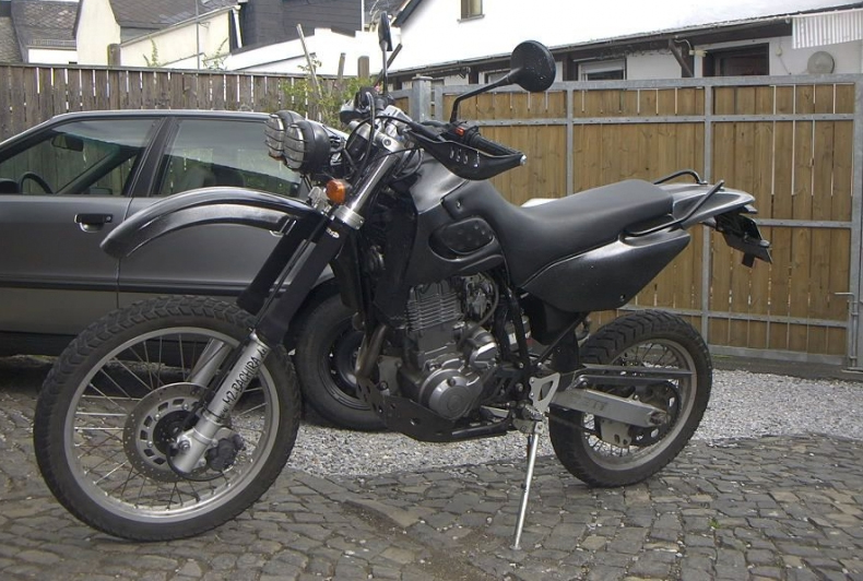

I did some searching of .de sites last night and found this example of a mastiff with a supertrapp can. These are the nuts with the KTM 640 guys and they talk about the number of discs they are running coordinated to their jetting. Im trying to find out if Supertrapp sells this abroad and if so can they get me one or quantity of the intermediate pipes? The second picture shows a serious chop of the radiator shrouds. I think a great aftermarket component would be a combined radiator guard and radiator shroud support that uses the 7/8" tubing mount to the frame and the front frame bar for support, an idea anyway. It would allow for shrouds a big bigger than those here but smaller than cutting the pipes as on phlats bike, an idea anyway.
mastiff tank chop.jpg (320.42 KiB) Viewed 8973 times
MZ BAGGY WITHSUPERTRAPP.jpg (331.1 KiB) Viewed 8973 times

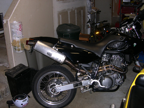

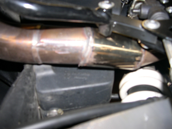

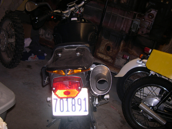

Postby phlat65 » Tue Oct 05, 2004 9:17 pm
here are pics of the YZF pipe installed. I cut the 2-1 of the stock pipe, used a 2-3 inch peice I cut out of another junk exhaust I got for free to join the 2 sections, and fitted it and welded together.
2001 MZ Black Panther
phlat65
Posts: 735
Location: Seattle

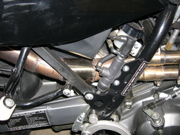

Postby phlat65 » Tue Oct 05, 2004 9:18 pm
last pic

Postby Randew2U » Thu Oct 07, 2004 12:37 am
The picture above showing the Mastiff with a Supertrapp system is on the german muffler web site and the contact listed there is mbk@rsj.de. Can someone who writes german please do me(us) a great favor and email him asking the following? "Is your Supertrapp exhaust system off-the-shelf? What model for? Is the midpipe custom fabricated, or from supertrapp? thanks"
Thank you in advance!
