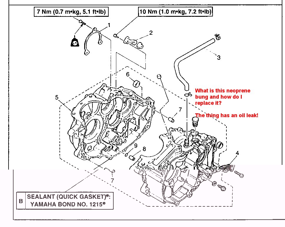

Postby sapperk9 » Sun Aug 02, 2009 12:14 am
I have an oil leak!
I've got the part:
Questions?
1. Do I remove the buggered one just by prying and picking?
2. Inserting the new, press, clout, and done, or do I need some gloop too?
Advice appreciated.
Thanks...
Unnumbered and uncommented neoprene/rubber(?) bung...
Yamaha 3YF-15167-00

Postby Bill Jurgenson » Sun Aug 02, 2009 1:51 am
In the original design, the clutch lever shaft went in here, disengaging the clutch with a push rod thru the trans.shaft.
It has an O-ring so you need only press the new part home.
