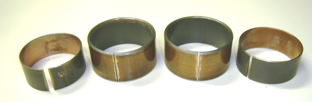

Postby kman.45 » Wed Jan 17, 2007 8:03 pm
phlat65 wrote:to remove the bushings on my USD forks, once the dust seal is removed and you remove the ring that retains the seal, just use the inner tube like a slide hammer, by sliding it out forcefully until both the seal and bushing come out. I have serviced forks many times this way, and is how my suspension guy would do it.
Hell of a tip! I put the inner bushing back on, pushed the inner tube back into the outer, gave a tiny tug and the outer bushing slid right out!
Here's a pic of the bushings. Left fork is on the left, you can see the extra wear on that side. The outer leg bushing is significantly more worn than the right leg, and the scoured part you can see is rough. The inner bushing was more worn than right side also.
kman.45
