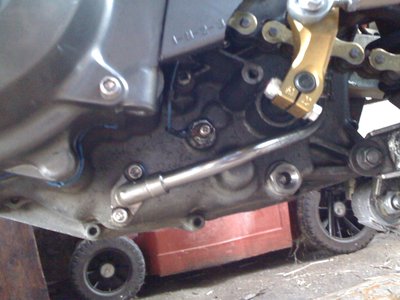

Does anyone know where the neutral switch and the wire connected to it is located? I have had a look in the xtz manuals I have as pdf files and the photo's are not very clear. There is (according to the manual) a wire near to the starter motor gears. I need to test the switch first for continuity before I replace the bulb.

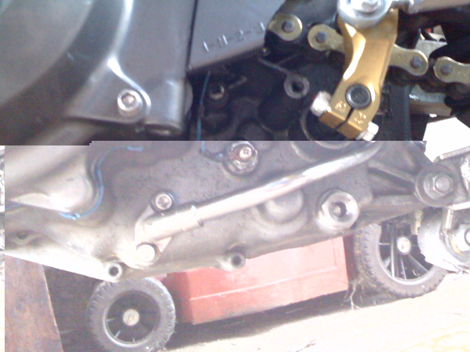

on the left side under the cog, above the oil feed and drain plug. it has a hex in the center of which is a Phillips head screw which fastens the blue wire with a slotted eye.
I have uploaded a pic:
neutral switch
