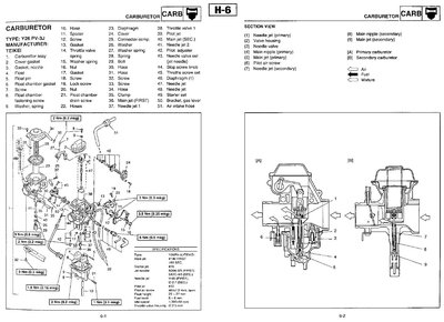

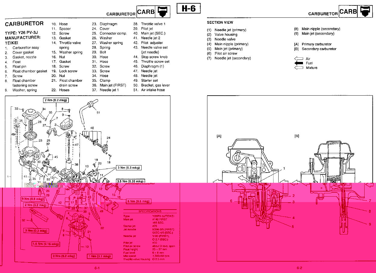

So can I ask, where is the pilot Jet in the pictures above???
Seems impossible to find a diagram of these carbs anywhere!!!

Look for a Yamaha SZR workshop manual as it covers the important bits such as engine and carb (can be found on the web for free)
Dont forget to clean the tiny mesh sitting in the carb housing above the float valve... it is not covered inte workshop manual....

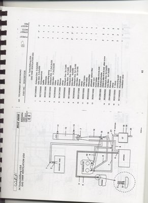

...I have one pipe which I dont know where to connect.
its a breather pipe, so nothing serious, and comes off a T connection from another pipe towards the back of the right hand side carb...
In the picture its below and to the left of the carb. you can see the end of it...
...any ideas??

Here's the vent schematic.

Postby basser23 » Wed Nov 03, 2010 3:56 pm
Dave, on the picture where the vent tube is hanging loose...I'll bet it' goes to the vent on the left carb that is located between the carbs under the
bracket that holds the carbs together.
take a look...

Yup, I have a 2002 Baghira BP, that has a stock carburetor which is the same on Dave's pictures above.
I found the adjusting screw as you've told. Yesterday made an adjustment with no success. Today will try it more. But i need to learn what a turn is. Is it a 360degree turn, or just a 180degree turn. Or as you said, turn number does no matter at all. Is it just the good working level sound that coming from engine which tells me the right level? You agree with this?
I have some other problems here. As I have bought this bike new, it has some weird situated pars inside.
I cannot adjust or move (tighten or loose) fuel vent screw, which is part number 21 on this page. It has got stripped (I'm not sure if thats the right word). Will it create a problem in future? Do I really need a new screw there?
Part number 40, again on that page, which is main jet. Is there an adjustment for it, or do I just put it in tightly?
In short I wonder that, is there any other screw that i need to adjust other than pilot screw set (part number 40) like jet pilot, main jet and those above?
As Anders wrote, there is a small diaphragm on the first carb. I think i need a repair set for it. I see dust on it, and that was the part which was bent when i first open the carb.
One more question about part number 57, which is pipe on the right side of second carburetor. I think the carb gets air from it. When i close the pipe, motor stops running.
