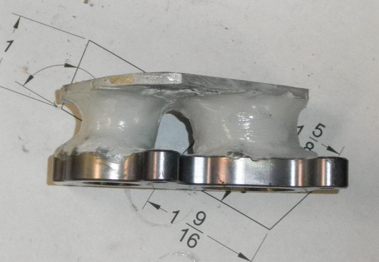

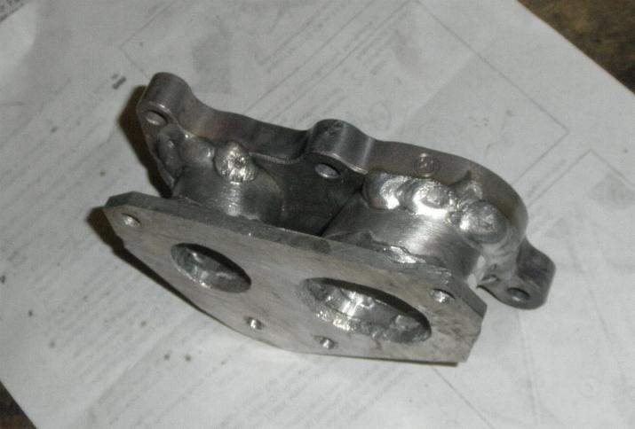

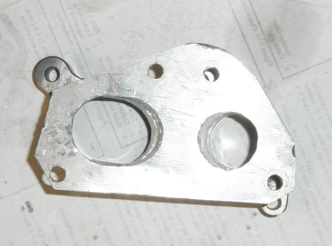

The Grizzly as I should have known but it had escaped me, has the same size ports, but they are 1/2" closer together. So I made out of 3/16" aluminum a plate that would bolt to the manifold. Here is the hardest part, and you just about need a milling machine or you would spend quite a while with the die grinder. Even with a mill, I used my die grinder with a 2 flute carbide router bit, as grinding stones pack up with aluminum pretty quick, for the final fitment.
To join this plate that now fits the Grizzly manifold to the raptor 1/2" alumium spacer I welded mitered aluminum sch 40 pipe. As it turns out, 1" pipe ID matches the small port, and 1-1/4" slightly flattened into an oval shape fits the larger port. Not perfect, but close enough I think after some grinding on it. I spaced them at 1" in length. The manifold Bikeworks was making looked like their tubes were 3-4 inches long, but I was advised to keep the overall length at 2" to 2-1/2", and with the Grizzly manifold I am still longer than that. Any shorter would make it a bitch to work with. It will be longer than stock in any case, which should increase mid range torque all by itself.
You can't weld all the way around the tubes, at least I couldn't, so I covered the outside with silicone to seal it. I had to grind some of the ports again after welding as the aluminum has a tendency to bulge in from the heat. My boot, air filter, and O rings are supposed to arrive this week, and I will report again after installation as to the increase-it better be an increase- this modification will make. At least now jetting changes will be a snap, and any jet you need is available pretty much anywhere. Mikuni makes 5 different size needles, and Dynojet makes some too. Having an adjustable accelerator pump should give the snap I need to stand it up in 2nd. If nothing else, I got to play with my toys again.
