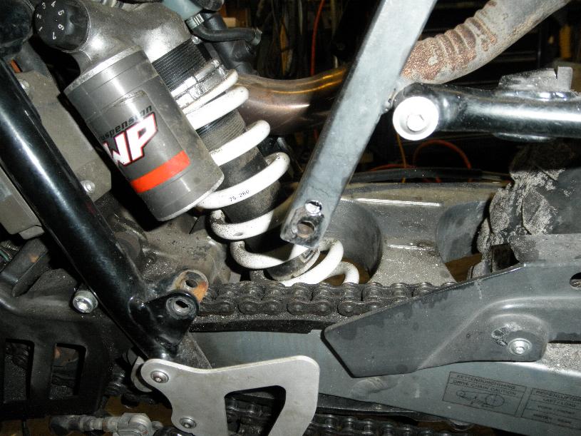

Here is another way to lower the seat, without affecting the suspension. I removed the airbox at the same time, so it may not work if you don't. Drilling a new hole and cutting an inch off the bracing dropped the seat to near level. Before it was slanted towards the gas tank.
