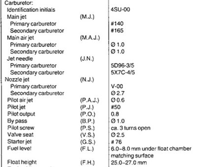

Postby Bill Jurgenson » Fri Apr 06, 2012 8:34 am
so this is for all XTZ engine including the MZ
primary main jet 130
secondary main jet 163
primary needle 5D963/5 (third of 5 notches, i.e. in the middle)
secondary needle 5X7C 3/5
here from the SZR handbook, the exact same carb but with a 140 primary main jet.

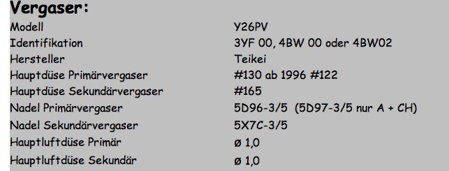

from the german page you see that the last Tenerés had a smaller main jet, 122, to better comply with CO measuring. You can safely try that and it should improve mileage.
Changing to a Mikuni TM34-B65 flatslide will get you much better mileage and performance as well.
