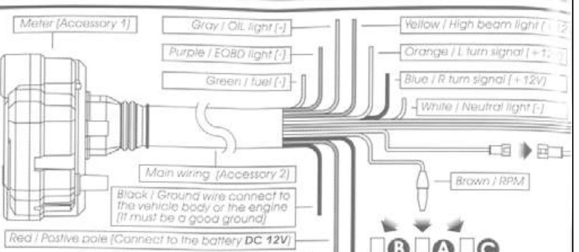

:smt006 Hi all, I've just fitted a Koso DB01R digital speedo to my 03 Baggie as per the instructions (a piece of pi#s I thought). All went well until I tried to start the bike, for some reason the side is now controlling the neutral light, with the stand down the bike will not turn over and the neutral light is on, lift the stand and the neutral light goes off and the bike will turn over???? I know the neutral light and the side stand switch both run through the same relay but I don't know how to solve my problem. :cry: The O.E. wiring had two wires to each idiot light but the digital speedo has a common earth so only reqiures one wire to each light. Any tips from electrickery boffins would be much appreciated. Cheers. Chalks.

Na that would be too easy :cry: I've tried it from both wires but no joy, from the other wire the neutral light stays on permanently. I've even tried wiring the old bulb inline in case it's a resistance issue.

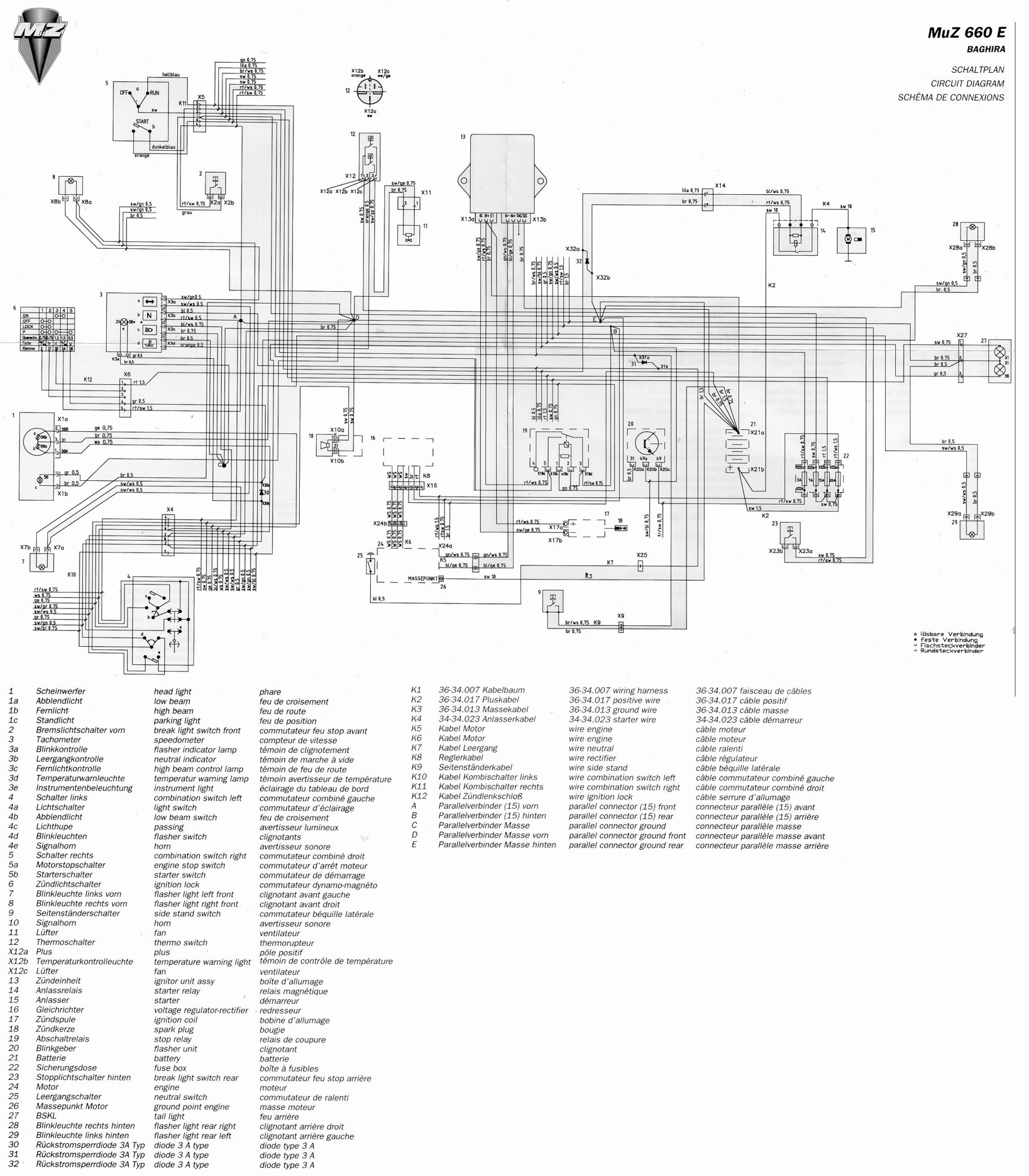

just reading yer post again it is wrong bro.... the neutral lighter has Bl wire, and RT /SW.... the RT/ SW wire is positive, and the neutral switch has one wire with the other side going to ground to make the lighter work... you will have to rewire the neutral light innit... item no .25 on the drawing is earthed.. so the other side has to be positiver

the side stand switcher and the neutral lighter are not related... the side stand switcher looks as thougher. it goes througher the start switcher and is series with it... so no worries with it there...

are you referrring to the baghira diagram posted.. as it is relay 14 starter relay, and 19 stop relay... item no.30 is a diode 30a...
would i be rite in saying that the only reason for relay 19 is for the side stand switch, and stop switch on handlebar...... and as i have my sidestand switch shorted out i could do away with it.. and i think the relay also disables power to the CDi.. pin.. no.. 5 off relay 19 goes to B+ on the ignitor unit.. plugger x13a item no...13... so this effectively turns power off to cdi and cuts the motor.. so i could wire that to the stop switch on handlebar.. i want to ditch the stop relay.. dont see any other reason for it...????

Postby DAVID THOMPSON » Fri Jan 04, 2013 7:04 pm
on the drawings there different numbers 19 on 125cc and i think 30 on an other
on the above drawing its number 19
there is a green wire in the mix that goes to the the side stand sw
when the neutral is on it gets grounded

Postby Chalks » Sat Jan 05, 2013 12:50 pm
P.S. I know the new neutral light if functioning correctly before it's connected to the O.E. loom as the light comes on when the white wire coming out of the digital speedo is put to ground. :(

Postby DAVID THOMPSON » Sat Jan 05, 2013 7:22 pm
i think the white wire goes to the neutral switch on the transmission
it may get confused if you try to use the mz interlock switches and diodes
the pin on relay 19 where the green wire hooks must ground for the bike to run
this thing and the diodes may make it not work
i am getting an idea of how the relay 19 works but have not built the whole mess on the work bench
and sorted out just how it all works
