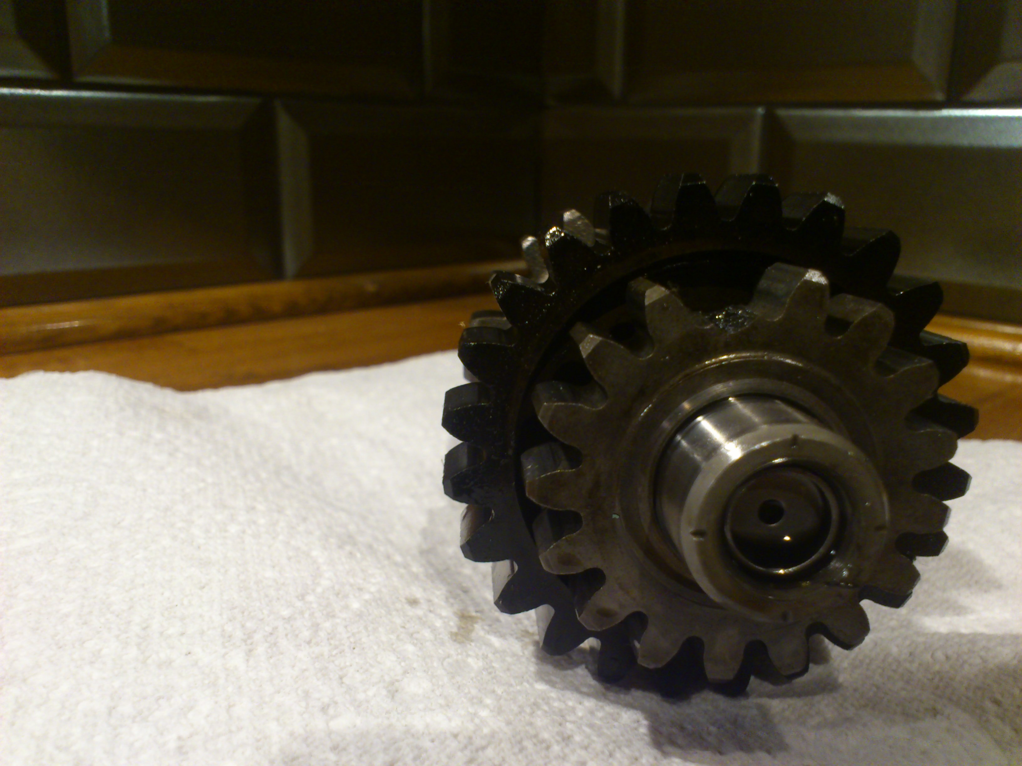

I discoverd this 2nd gear problem on my spare motor: Please note (Radiograf) I to have discovered the rule of turds ((without photo edit)) :smt005
P.S. PLEASE DO NOT ABUSE YOUR MOTORCYCLE BY TRYING TO WHEELIE THROUGH THE BOX WITHOUT USING YOUR CLUTCH, it's not big and it's not clever! :( :( :( OUCH!
