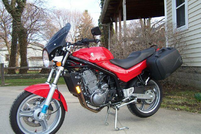

Postby dthemic » Thu Feb 05, 2004 11:02 am
just trying attachments with a photo of my MZ
stock tour w/bags & windscren

Postby 125SMash » Thu Feb 05, 2004 1:02 pm
nice :smt023

its nice to see what my bike would look like in Red! What windscreen are you using? This is a flyscreen from Holeshot.

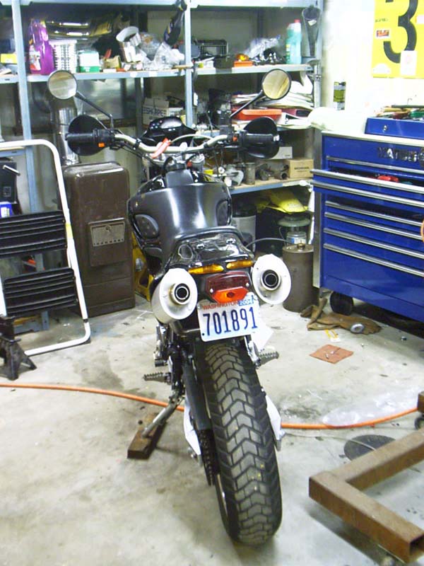

heres the back of my Baggy...

[quote="icannonball"][/img]
It's a Givi. The model is "Roadstar".Very easily removed and reinstalled. I like that. My bags are Hepko-Becker and look somewhat smaller than yours.

2003 baggy rear fender
Postby Brian » Wed Feb 25, 2004 4:46 pm
I cut the fender using nibblers (look like a drill body with small scissor like cutter) In place (not removed from bike) can use jigsaw and flat file
Took grab bars off and used 5/16" Carriage bolts (1 1/4" long) to re fasten side covers to frame at the side of the seat.
used toilet hold down(teebolts) to hold rear fender assembly to tail light assembly
I removed the tail light assembly to cut frame
I moved tailight assembly back in place to where rear light is flush with back of fender.... marked near holes with marker tip going through fender holes, drilled holes and re assembled
These aren't in order but pointers only, I'll send picts in a bit
