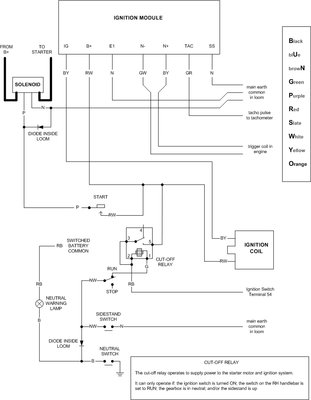

I wired my Skorpion for total loss. I will post the diagram. But it wont run! :(
Anyone smarter then me can tell me what I did wrong?
Hope you can see the diagram
Running the powertool battery. Stator removed.
I can also send anyone the wiring in email if you cant see it.
Please help! :)

Looks good to someone who doesn't really know what they are talking about. Do you have a relay on the kill switch and have you checked to make sure it isn't backwards? Try starting the bike while holding the kill switch down.

I don't have the relay there and I think that might be the problem now you talk about it.
I have the power to the coil but no spark as far as I can tell.
Oh and I do not have a starter on my bike.

Ok so here is so far what I know.
When I turn the switch ON I have the power to the coil and out of the coil.
I have the power to the ignition box to he 3pin conector on 2 pins then the 3rd pin is ground.
All same voltage.
When I move the engine there is no change in the voltage enywhere.
No spark!
Is the ignition box bad? Was running before I changed to total loss.
Or maybe no signal from point (flywheel)?
I know I'm missing something somwhere but I'm lost :(

Postby DAVID THOMPSON » Sat Jul 05, 2014 6:57 pm
maybe this will help
drawing from tony idle
click on picture may make it bigger
better view

Thx Dave, will check this out tonight and compare to mine. Hopefuly I can find the glitch :)

So far I think just by looking at it my problem might be that "cut off" relay which I can't find anywhere :(

Well I got the bike running again! :D
After going over everything many times there was still no spark at all so I opened the sidecover again and finaly find out the the pickup is not lined up with the flat spots on the flywheel by 13mm!
Well my bike is Sport and I switched that cover from Traveler. Im not sure if it was different on these two bikes or the MZ made some changes to the flywheel between years but anyway, made some 13mm spacers and raised the pickup and the bike fired right up :D :D
