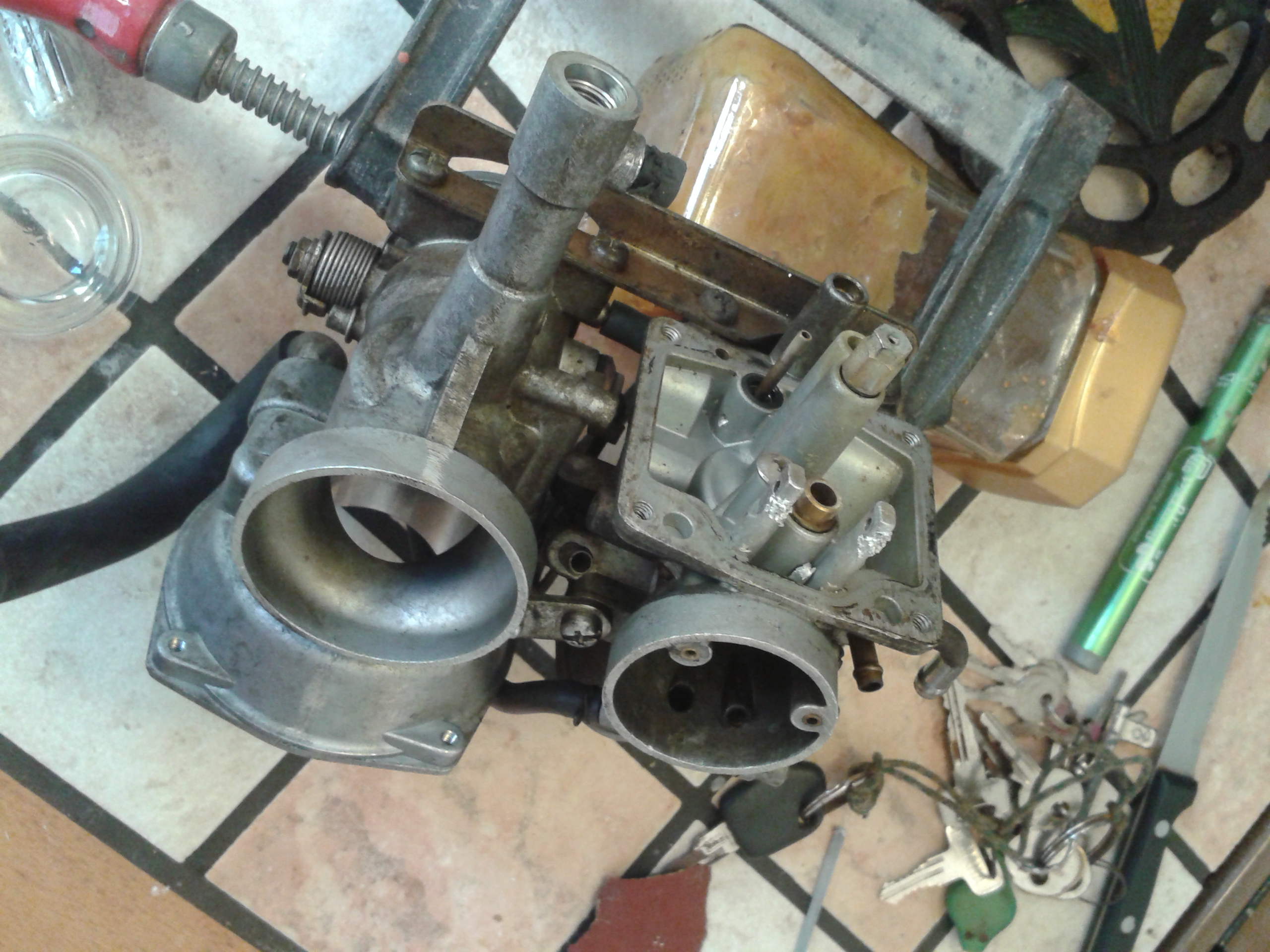

Yesterday I took the carb out and noticed that the fuel float stem is cracked. I did repair it successfully with Solder Aluminium.
I need your help guys now.

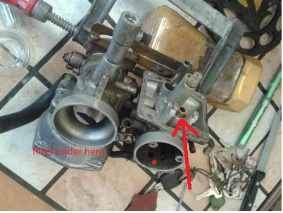

I heard that there is a small fuel gauze , but I do not know where to find it.
Also what is the float bowl height setting.
what should I look for i.e. I do the general cleaning but is there anything in particular I should look for? :?:
p.s. I need to check the fuel tap too there is a filter if Im not mistaken.
The repair has been done this morning just before going to work, the Solder need a bit of clean up but it is strong :D which I am glad .
You can copy my pic and draw arrows and comments as you wish, I appreciate any help.

Postby DAVID THOMPSON » Tue Sep 15, 2015 11:14 am
filter located at end of red arrow in picture
below the brass thing
Re: Scorpion Tour looses power after 2 km drive
Postby dandywarhol » Tue Sep 15, 2015 11:53 am
DAVID THOMPSON wrote:filter located at end of red arrow in picture
Be careful taking it out - it's a push fit but the "O" ring can make it bind and you may end up damaging the brass needle valve holder. I soaked some silicon spray down it to help it out and used a pair of long nose pliers with cloth between the jaws to avoid scratching it. A wiggle and pull and it should come out. Also might be advisable to have a gasket/seal kit handy in case the rubber "O" ring is brittle

Postby Henry74 » Tue Sep 15, 2015 2:29 pm
Thank you all for your replies.
I did not manage to get the brass fuel outlet bush but since the fuel pass trough it from the fuel inlet I did wash it well with acitone blew it with air and finished of with carb cleaner(acetone) again
I cleaned every orifice with carb cleaner too.
I checked the the airvent breakwellmz and with the help of my teenage son fuel is flowing well (compared it with an open fuel tap :) too )
the problem seems that the fuel float closes at 30mm and chuckinIndiana advised that it should be around 25 to 27 mm . so it seems that it is closing way to early no ?
Fuel in the bowl is low and that might lean the mixture. what do you think guys.
