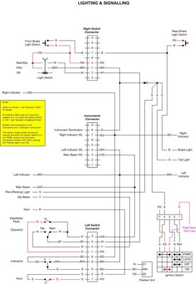

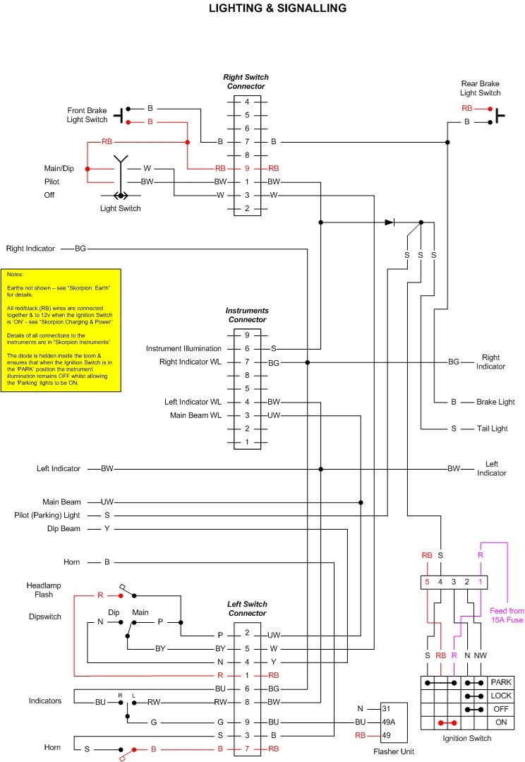

here is a drawing i have thanks to tony idle from several years ago
put main switch in park position if you have a front parking lamp and instruments
i would suspect the diode in the upper part of the drawing
click on drawing to make it bigger

oh , i know , lift the tank off , up front on the right ,there's a small black plug,9 pin i think , its loom will look all bent where its hugging the side,,pull it out and youll find one of the double black wires broke loose,,fyi,if you have spare computer flyleads,,the crimps are the same,i just soldered it back on , alls good

If not adn you want to replace the diode the rating is 6 amps 400 volts more or less P600B or highter.
What I did is took out the wiring loom and checked the wires one by one. they are prone to crackling.
If you dont want this I suggest to trace the offending grey wire from the rear to the front.
