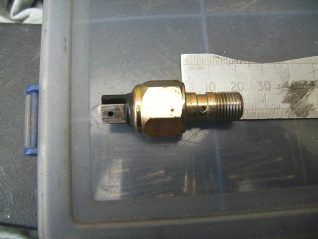

It turned up today.
After removing the current switch i found the new one to be to long.
However i can confirm that the original switch thread is 1mm pitch x 18mm long.
After putting the original switch back in, it now works!
No fluid was lost during the swap-over, so far simpler than i thought it was going to be.
