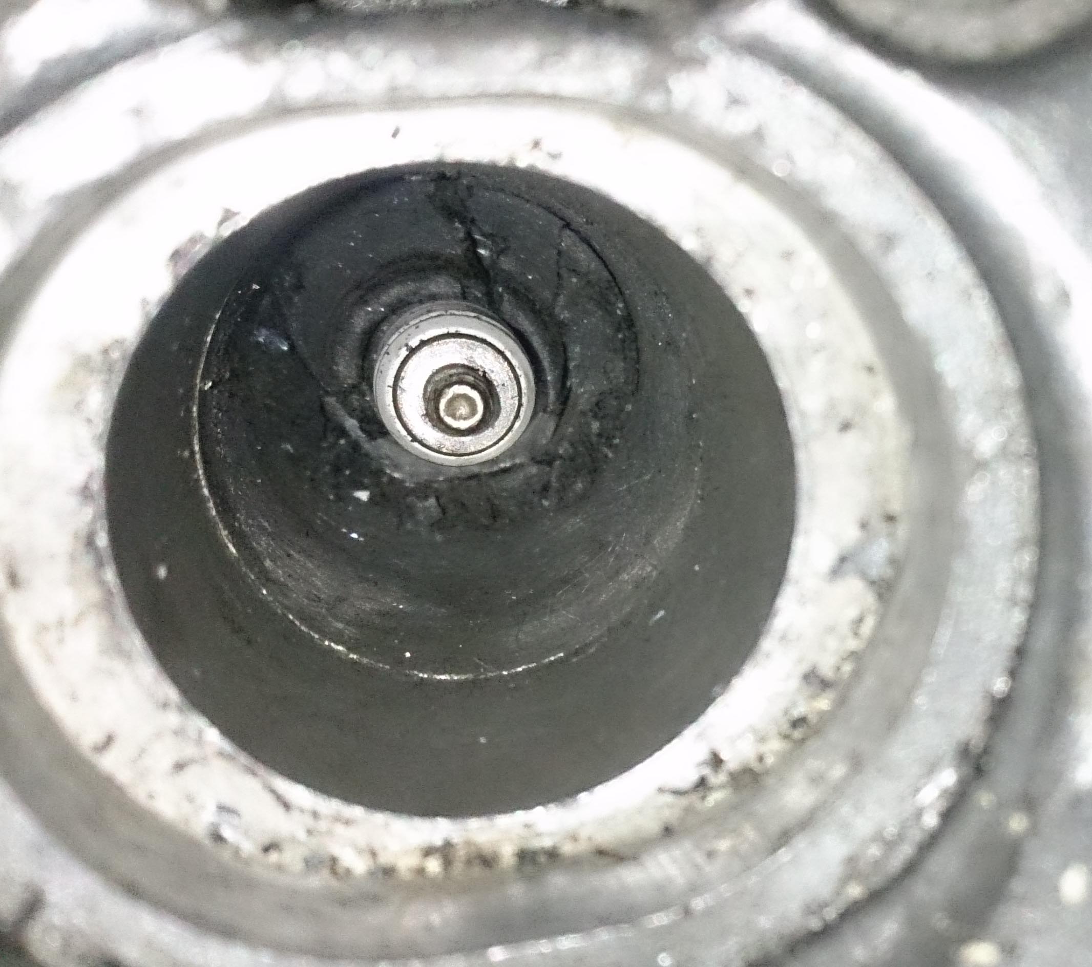

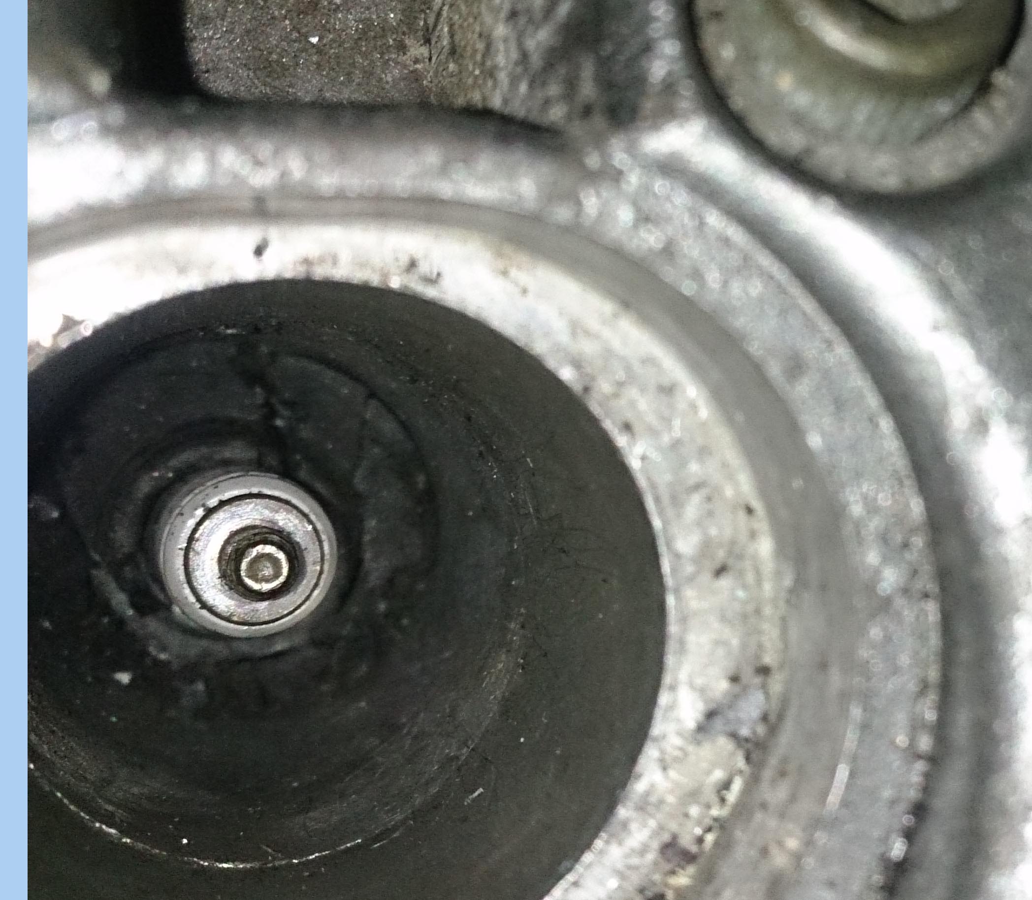

What should be a simple job is proving difficult. Tried to remove the plug preparatory to doing the vales and could not get the plug spanner to engage. The picture shows why, there is some sort of rubber bung sitting on top of the plug but so far no amount of digging around with hooked wire and suchlike has shifted it. It seems to be jammed very tightly and my knuckles are raw trying to dislodge it. My guess is that the rubber is from the inside of an original MZ or Yamaha plug spanner which has become detached and then pushed down by the plug cap but why it should be so tight is a mystery.
Anyone had this problem and if so how did you solve it, I am going to try grinding down an old kitchen knife to make a chisel to try and cut it into smaller chunks but you are working blind all the time and the confined space makes it hard to get any real pressure on the tool.

Got the little blighter out in the end using my modified kitchen knife as a chisel to cut the rubber down the side of the plug and a piece of wire with a hook on the end to lift it out. The reason it would not come out easily before was it was partly trapped under the spark plug. It was actually the rubber end cap from a long reach angled plug cap which must have become detached though how anyone managed to screw the plug in with it in place is another mystery.The plug cap in use now has its rubber cap in place.
