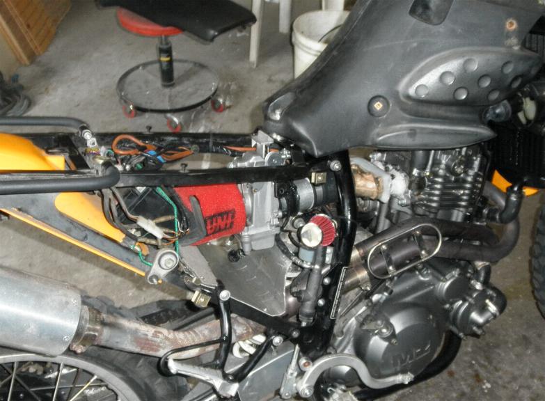

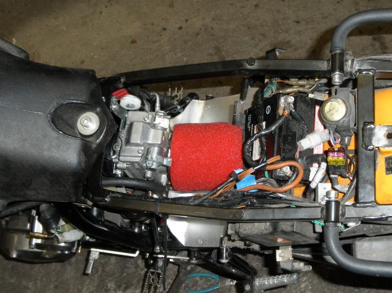

Can anyone recognize these images and more usefully their origins please?-

Not sure where these images came from, but the carb is way too far from the engine, and the 2 into 1 inlet manifold looks very restrictive, carb should have been mounted in the original location with other mods if determined to use the new carb. This set up is not to be used in cold weather, it would probably ice up the carb. :-)

It is a very, very long inlet tract as you say.
I`ve read good reports of people using single carbs on SRXs` and XTs`with Yamaha 2 into 1 manifolds.
