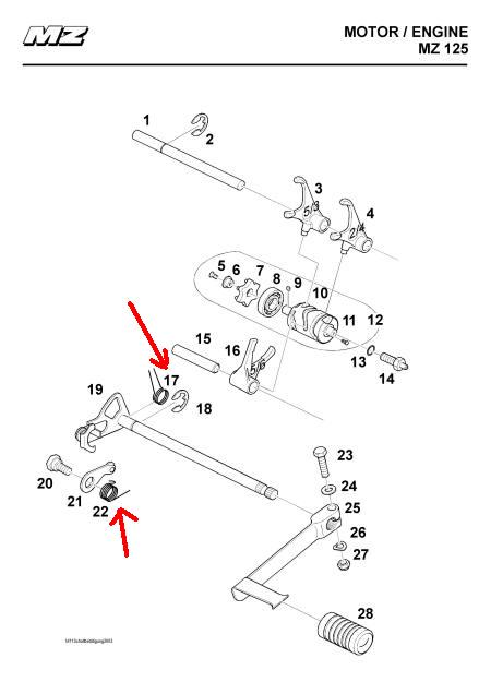

Before I crack this thing open again, have any of you seen this before? I'm thinking maybe there's a spring somewhere that's either broken or become unseated somehow. There's a likely-looking candidate in the parts book, but I figured I'd at least consult the foremost authorities before I start.

Postby DAVID THOMPSON » Tue Jul 03, 2012 1:17 am
item 17 is the best guess
its behind the clutch plate carrier at the bottom rear of the engine on the right side
check the no 22
but 17 may just be back in there wrong
WARNING THE NUT ON THE CRANK IS ANTICLOCKWISE OR BACKWARD IF I REMEMBER CORRECT
THE CORNERS OF THE WRENCH FACE HAVE A SMALL CUT TO INDICATE REVERSE THREAD
LOOK AT THE HOSE NUTS ON A GAS WELDING BRAISING TORCH YOU WILL SEE THE SAME MARKS
SO THE HOSE IS ON PROPER
YOU MUST REMOVE THE CLUTCH BASKET TO REPLACE THE CENTERING SPRING
GOOD LUCK
DAVE
17 3747022000 RETURN SPRING

Thanks for the insight, David. That's the spring I was thinking about.
I took the side cover off again today, but (without further disassembly) everything seems to be unbroken and properly seated. What's more, the shifter seems to move okay and return to center with the cover off, but of course I can't ride it like this to test so I can only wiggle it while rolling the bike back and forth.

Postby DAVID THOMPSON » Tue Jul 03, 2012 9:55 pm
item 21and spring 22 work against item 7 a shiftier pin wheel
make sure its all in order
i do not want to take the clutch basket out of my spare mot0r to see how it all works
and do remember to watch the spring and ball bearing that sets the oil pressure
as it can fall out of place and then oil is all messed up
also too thick a gasket can cause pressure problems and sidecSE IS OFF ALLOWS BEARING AND SPRING TO GO missing
item 7 may be binding with item 21
