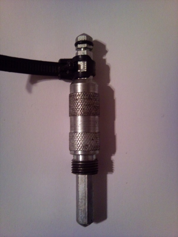

A timing tool can be bought from Burwin motorcycles in London by mail order
Timing tool for MZ 2 strokes.
It's item P000149 at http://www.mzspares.com/toolsengine.htm
The tool is screwed into the spark plug hole. The sliding metal rod has markings spaced every millimetre. (The adjustable cable tie is my addition).
To use this tool you have to turn the engine so that the piston is at top dead centre. When the piston is at TDC the sliding rod in the tool stops moving up or down. Then you turn the engine backwards so that the rod drops by 2mm (2 gradations). This is the setting at which your points need to be opening (assuming that the timing required is 2mm before TDC). This can be checked by connecting a 12v bulb across the points. When the bulb lights (ignition on obviously) your points have opened.
I assume that you now have an idea of the procedure.

My ETZ 251 kicks back most times I start it; even after I've checked the timing (it has electronic ignition but still needs checking periodically). I just assume it's "one of them things" :-D and keep my foot firmly on the kickstart; this seems to minimise the actual kickback.
Intigued to see the timing tool, must buy one next time I visit Burwins, I currently use calibrated coffee stirrers and a little digital multimeter to find the point where the voltage changes!
