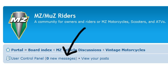

Postby ghostinthemist » Mon Apr 09, 2012 8:41 pm
??????????????????????????? Mail?????????????
ghostinthemist
Posts: 58
Joined: Sun Aug 07, 2011 8:30 pm
Re: KEEP F!#$%^& UP cylinder studs!
Postby DAVID THOMPSON » Tue Apr 10, 2012 9:50 am
right hand side of page at top
under your name when you click on PORTAL on the left near the top
Postby therealche » Tue Apr 10, 2012 1:24 pm
