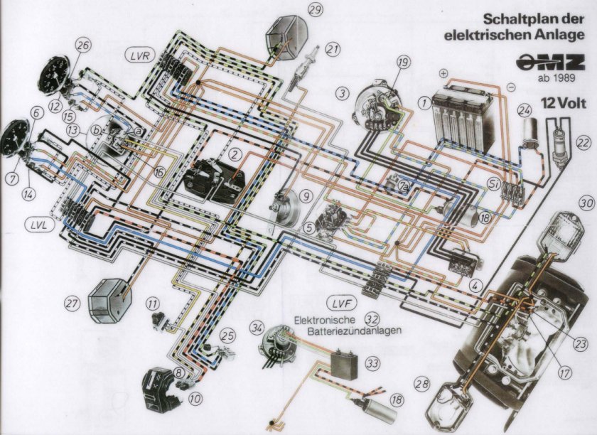

With the compliments of http://mzclub.foroactivo.net/t856-esquema-electrico-mz-etz-250:
http://www.miraculis.de/aw/mz/text/etz251bs/schalt.jpg
any ciber screw-ups are my responsibility.
I think the electronic bits are the ones at the bottom right.
Louis

sorry louis, That dont help much as they both show the Old points & mechanical regulator system, not the later electronic systems

Postby Louis Mair » Thu Jul 12, 2012 9:28 am
BOTTOM RIGHT; ELEKTRONISCHE BATTERIEZUNDANLAGEN; NUMBER 33 HAS SIX WIRES

Postby Trogolodyte » Fri Jul 13, 2012 2:15 am
Still don't help much as I already have that wiring diagram, its the one I posted on 26th june, this one, ( http://www.ostmotorrad.de/schaltplaene/ ... an_12v.jpg )
and besides its irrelevent now because as I posted on the 9th July "It would seem to me that I am going blind in my old age, and am in desperate need of ocular clarity. I have just found the rest of the loom and there tucked away underneath the other side of the barrel was the damned thing I was looking for. Its tiny in Comparison to other CDI's and ignition control box's, from similar bikes of the period, like the nippon denso unit on the Rotax Mz bikes and a few of the older Xr250 and cb250's... but then it is in a dark 8x10 shed... thats my excuse and am sticking to it."
