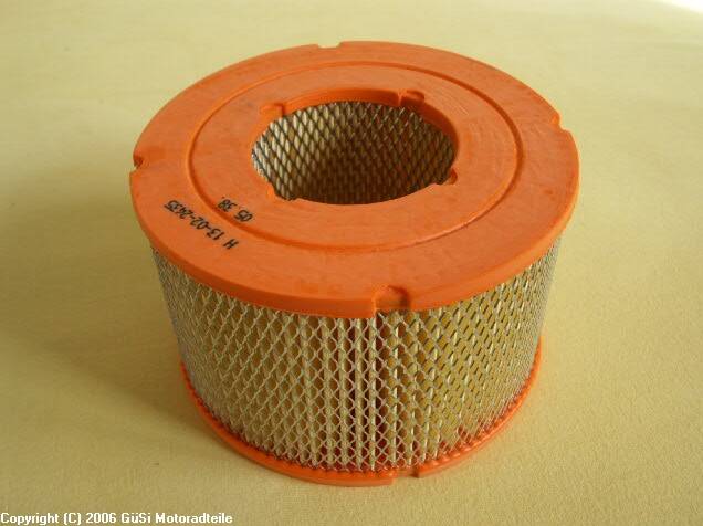

Postby Guesi » Sat Jun 22, 2013 4:05 am
Does it look like this one ?
Then it is a dry filter made from filter-paper.
No use of oiling it....

Postby snuffpig » Sat Jun 22, 2013 4:55 am
That's the one. Expensive though, cost me £14 delivered!
