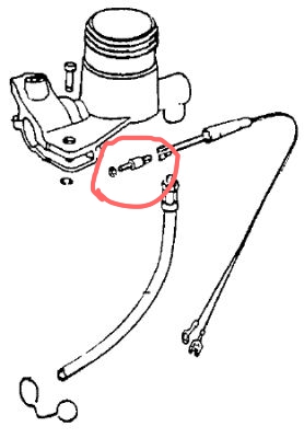

If it is a Square master cylinder
96 24 451.jpg (44.42 KiB) Viewed 5511 times

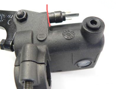

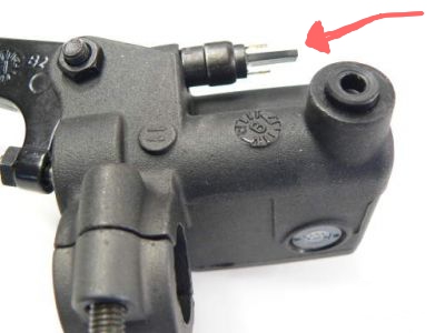

If it is a round one
And they are horrible fiddly things that break if you look at them wrong!

Re: Front brake switch
Postby Deedum9 » Sat Oct 19, 2013 3:10 pm
Brilliant, thank you, this means mine is broken then, I'm guessing sourcing one will be relatively easy ?

Postby therealche » Sun Oct 20, 2013 3:22 pm
Quite often the switch breaks flush with the master cylinder
Just leaving the threaded portion corroded in place. It's one of the few times I would use an easyout to get the threaded bit out
