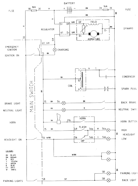

I always find the original MZ one easy to use.
http://www.mz.cx/technik/elektrik/schaltplan-6v-l.jpg
Click on it to enlarge , I had one printed out A3 and laminated.

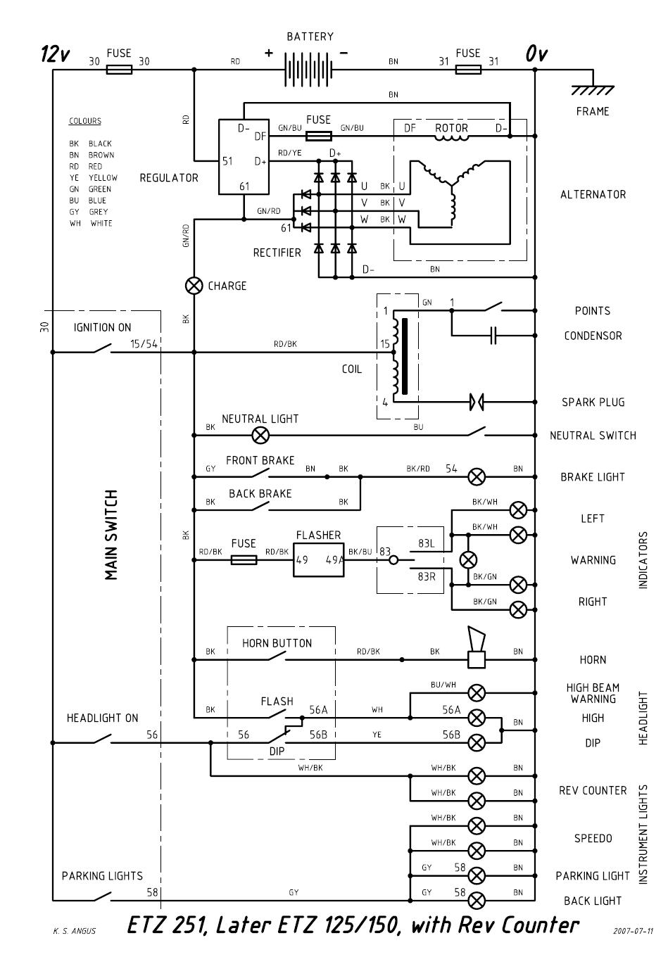

page goes crazy when it displays on my machine
i think this is it
and it may be the screen size as the other computer displays it ok
click on pic to see it bigger
Re: wiring help needed
Postby therealche » Fri Jul 25, 2014 5:36 pm
You need to swap these for the 6V ones Dave.... it's a TS not an ETZ

den send me the 6 volt drawings in a pm and i will clean up this posting
Postby den » Sat Jul 26, 2014 5:19 am
ok , this is it ,,obtained from here--http://www.moser-bs.de/
