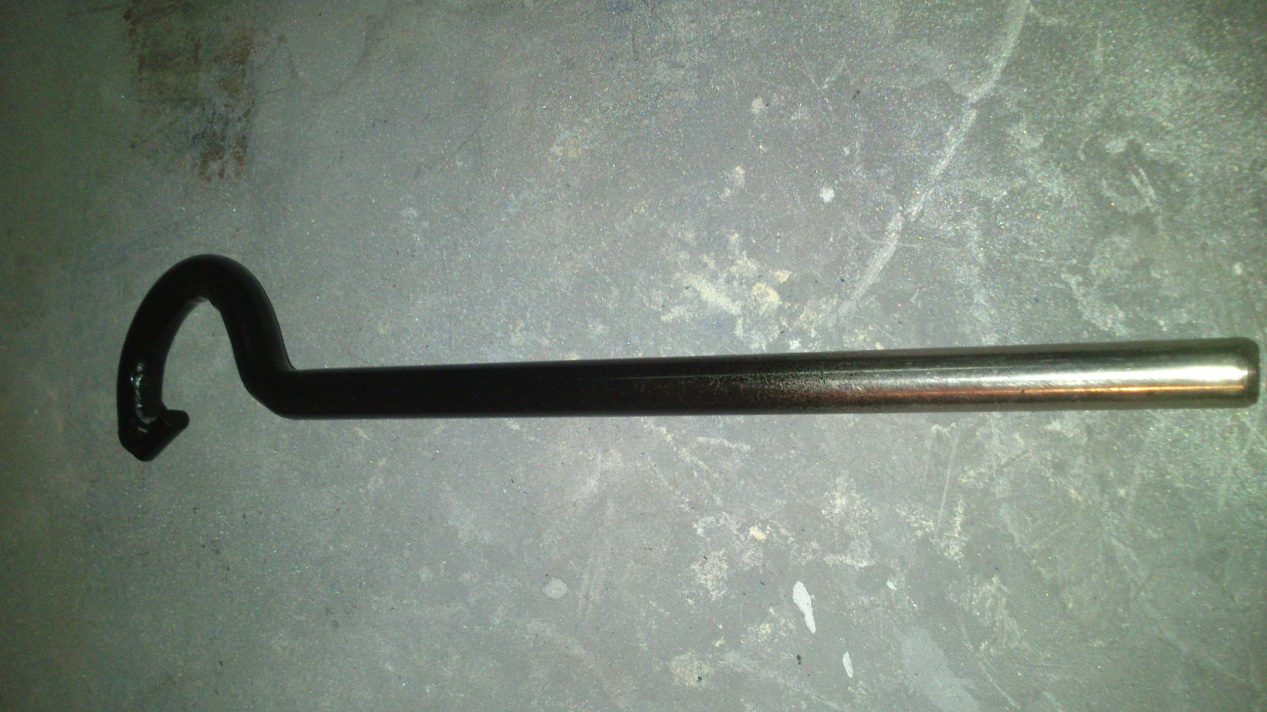

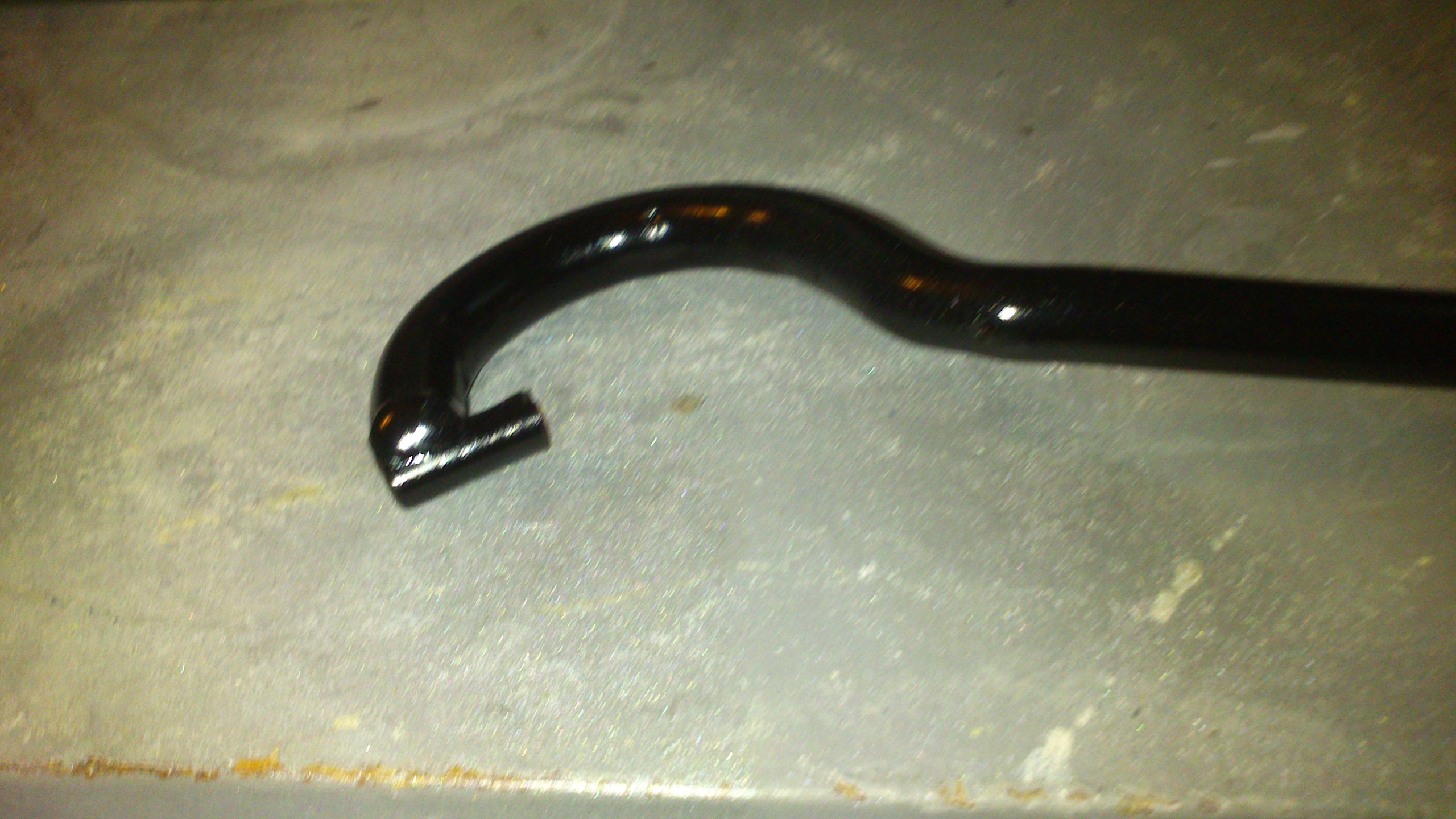

I had to make this tool to fasten the exhaust nut since my adjustable C wrench wasn't being effective :
Works like a charm, contours the frame and since it was made from strong steel, doesn't even bend :D
