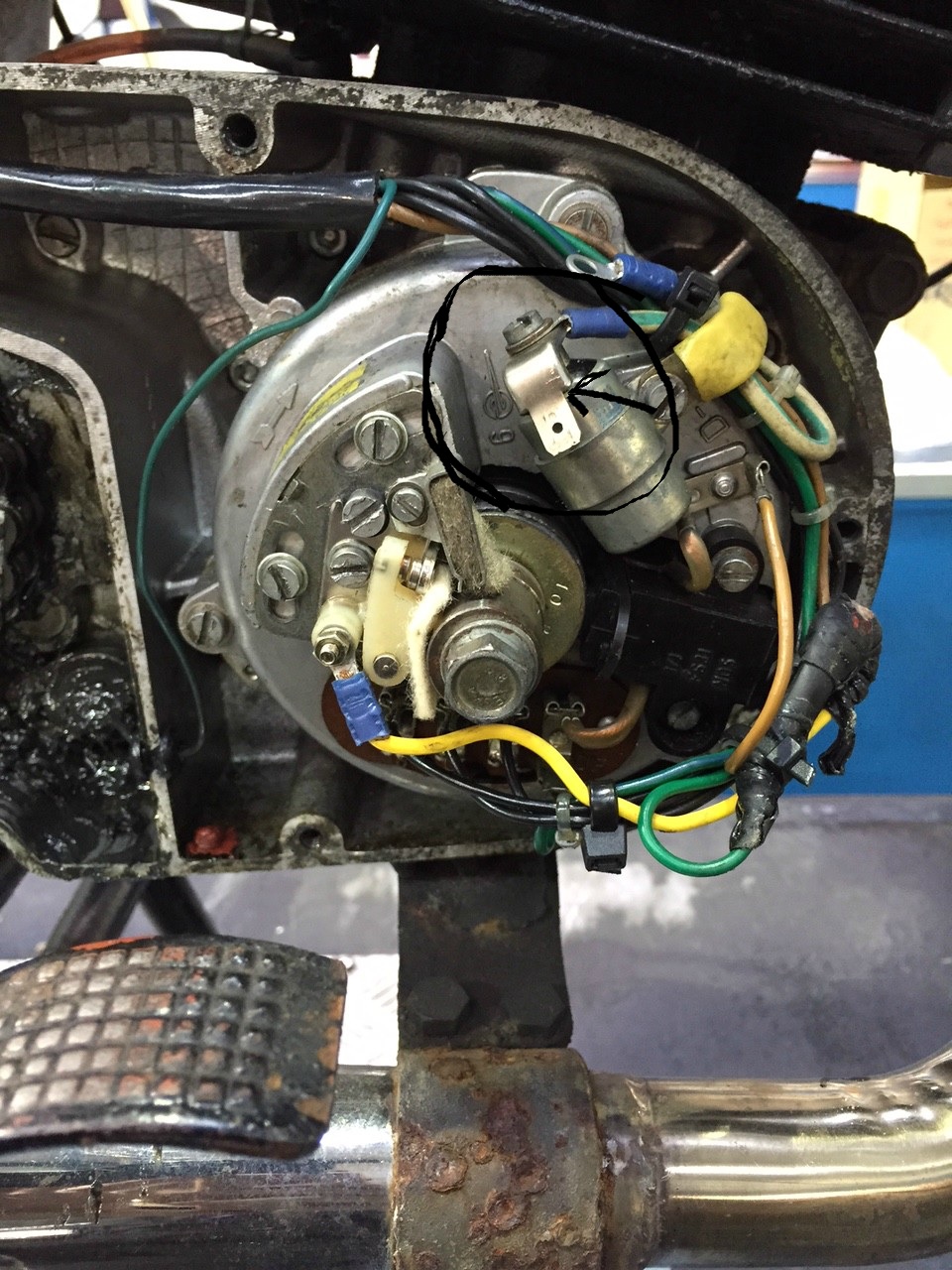

Here's a picture of the points/generator area that will hopefully give some indication of the kit.

Re: Semi electronic ignition/click or tick
Postby therealche » Thu Jul 02, 2015 9:52 am
Ah... it's the other end we need to see! It still has points so it is probably on of the electronic assist systems

Postby DAVID THOMPSON » Thu Jul 02, 2015 11:51 am
look at this pic at the high lighted area you may have a short to the condenser case
looks a bit close
click on pic to make it bigger
Postby Tome » Thu Jul 09, 2015 8:42 am
I'll have a look at that, it doesn't appear to be connected to anything so hopefully I can just bend it back a touch.
