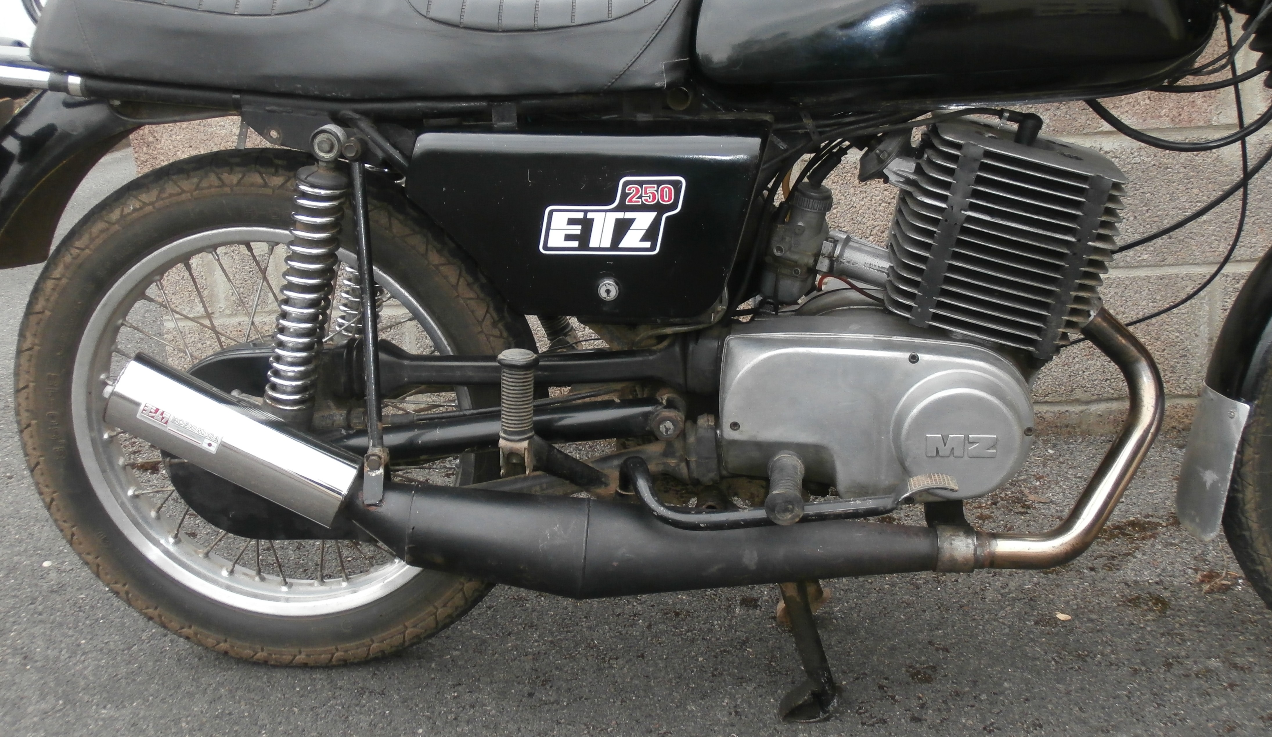

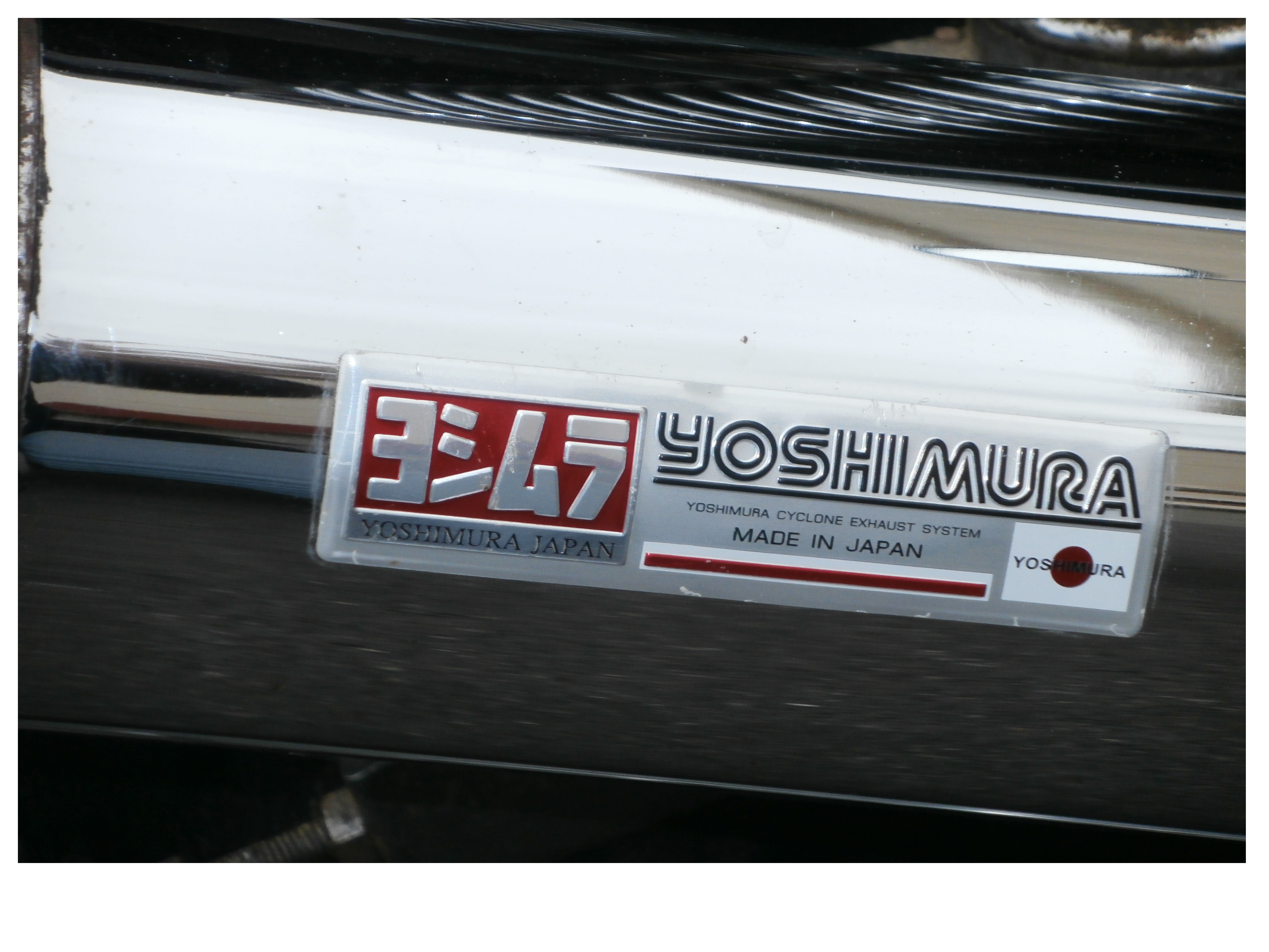

Postby Andy_C » Sun Apr 29, 2018 1:29 pm
dirtsurfer wrote:Let's see a picture Andy
You asked so here they are.
Pretty sure it is just the "run of the mill" one that is readily available - I think the "Yoshimura" Label was fitted by the previous owner and I'll be leaving it there just as a talking point :D

Postby dirtsurfer » Sun Apr 29, 2018 3:47 pm
Good find!

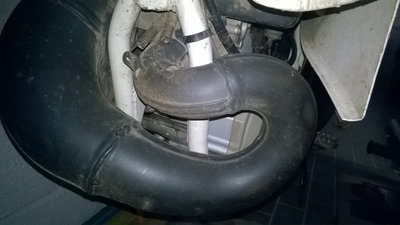

Not at all trying to go into a contest, but just to illustrate what I said earlier, see the exhaust of a '92 YZ250LC:
YZ250 exhaust.jpg (21.32 KiB) Viewed 10818 times
The minimum OD is 54mm, so in x-section some 78% bigger than the standard MZ250 header pipe, of about 41mm OD (assuming 1mm wall th in both). And it tapers all the way.
Not a problem, Puffs - it is a known fact that tapered headers on 2t expansion chambers make better power than parallell headers and I dont doubt that the chamber I have could be improved on.
From my perspective it replaces the original tatty standard item, and performs pretty much on a par - so as you say a good find for £20.
