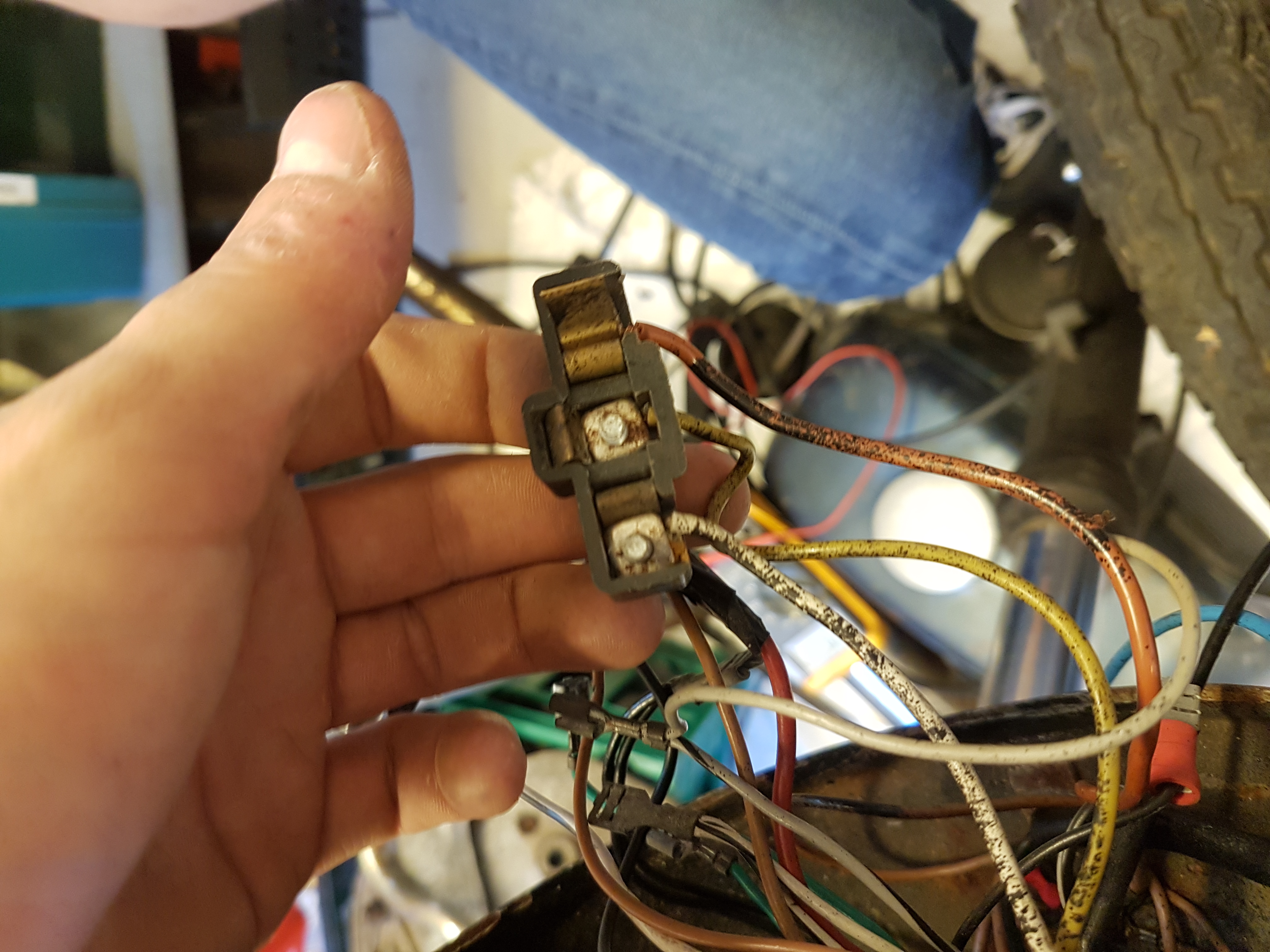

Hello, i have some trouble doing the wiring. I don't know how to wire this part correct, and i cant get the parking lamp to work. And also i'm not sure if i got the left hand switch correct. I got the horn on the button to the side and the button on the bottom does not do anything.
I would really appreciate your help and i would love to see how your wiring looks like in pictures

Ohh, and i forgot to tell that it's the grey wire i don't know where to put in there

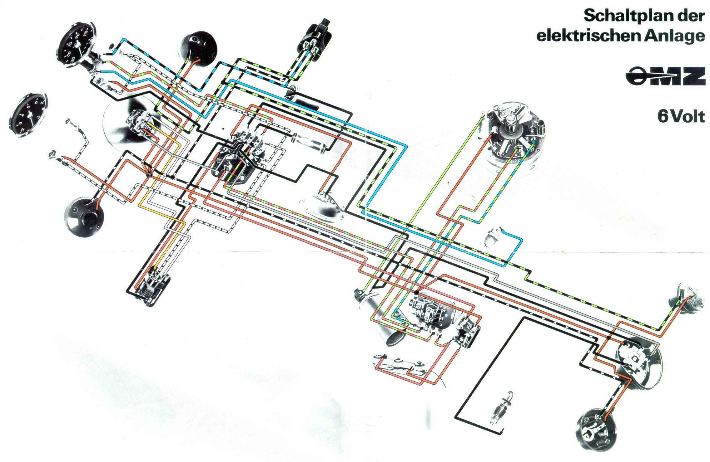

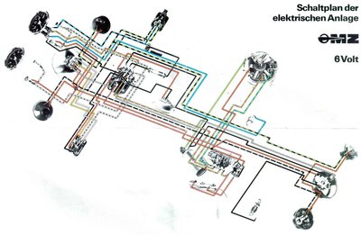

Postby Blurredman » Wed Oct 03, 2018 2:30 am
I believe the yellow is high beam, the white is low.
Grey is the side lamp bulb. Brown is earth.
I have attached a colour Diagramme for you. 8)

Postby Elvang » Fri Oct 05, 2018 10:10 am
Thank you very much. I got it to work now
