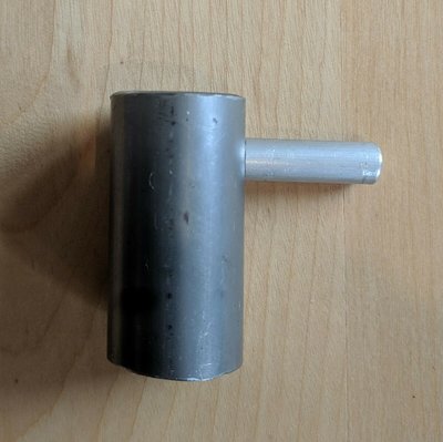

Postby MotoMZ » Fri Mar 08, 2019 3:50 am
