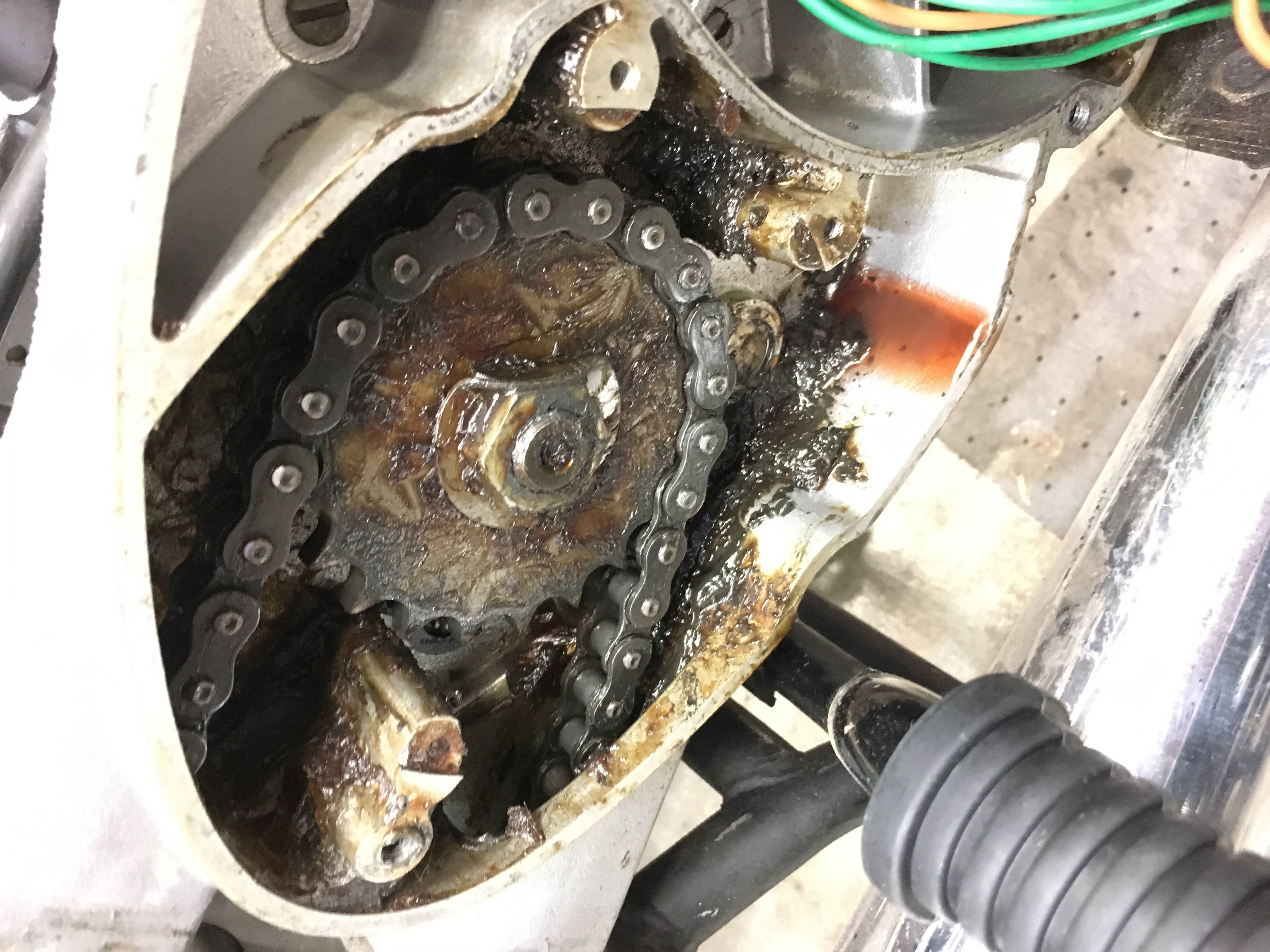

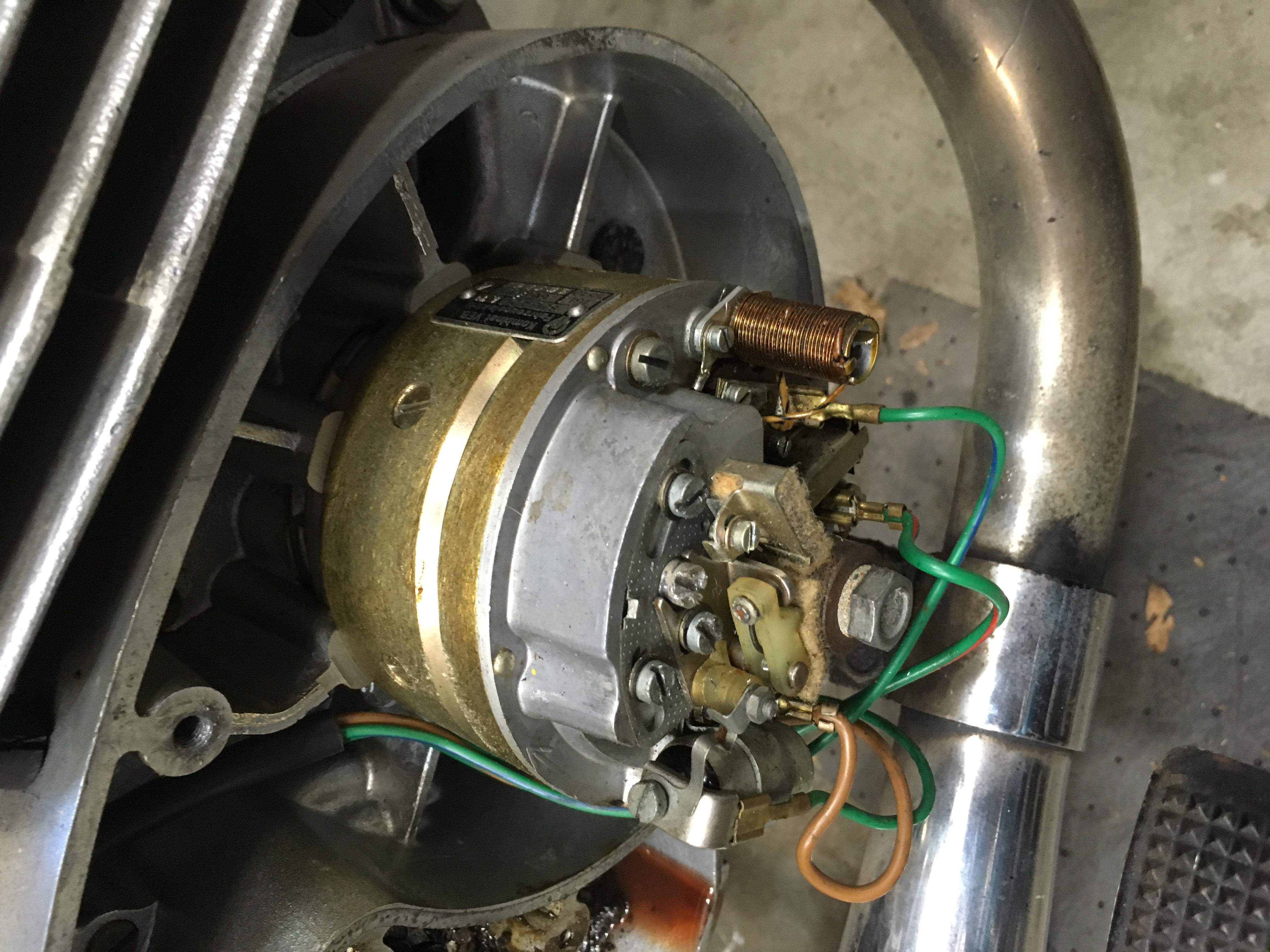

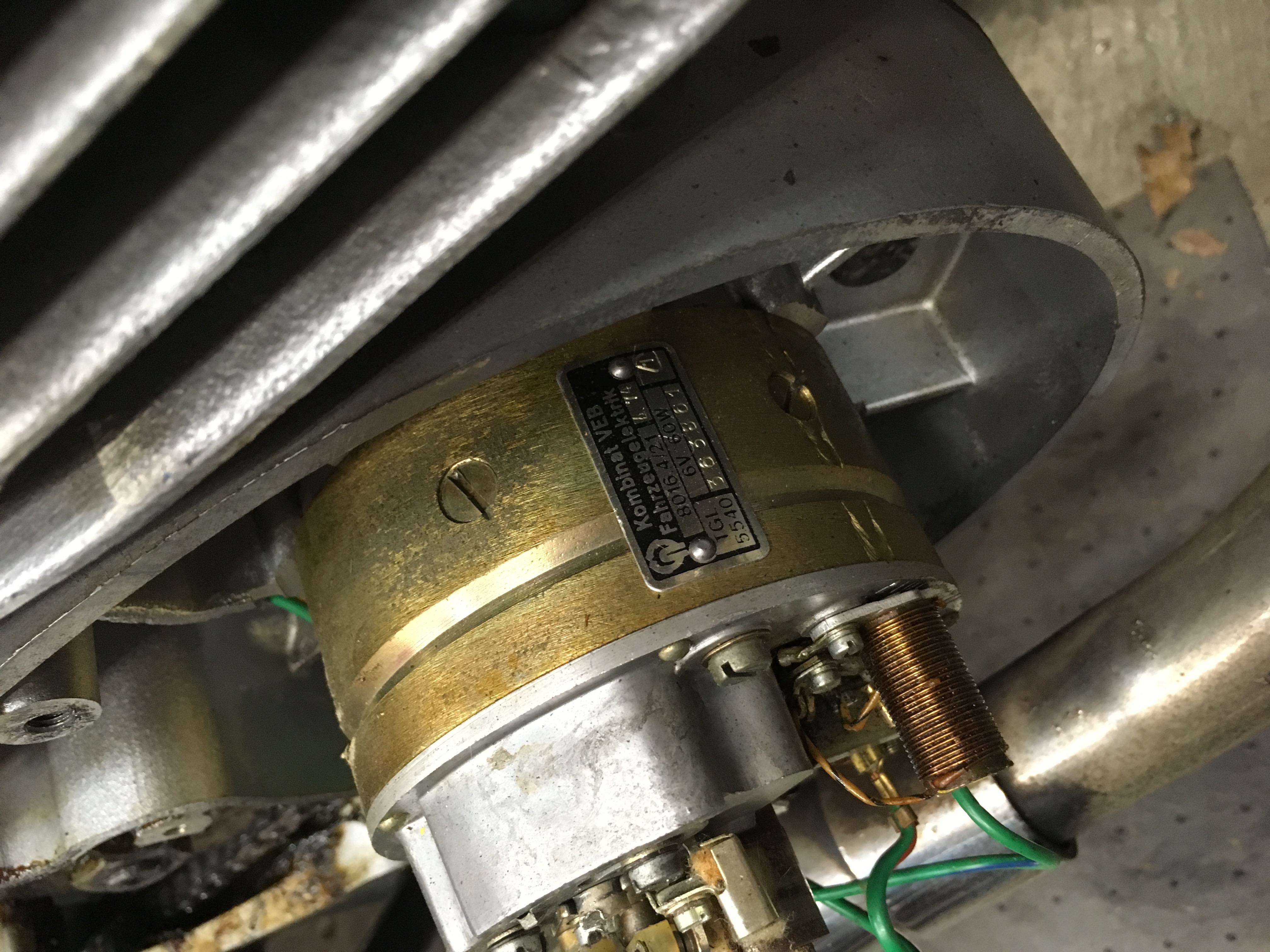

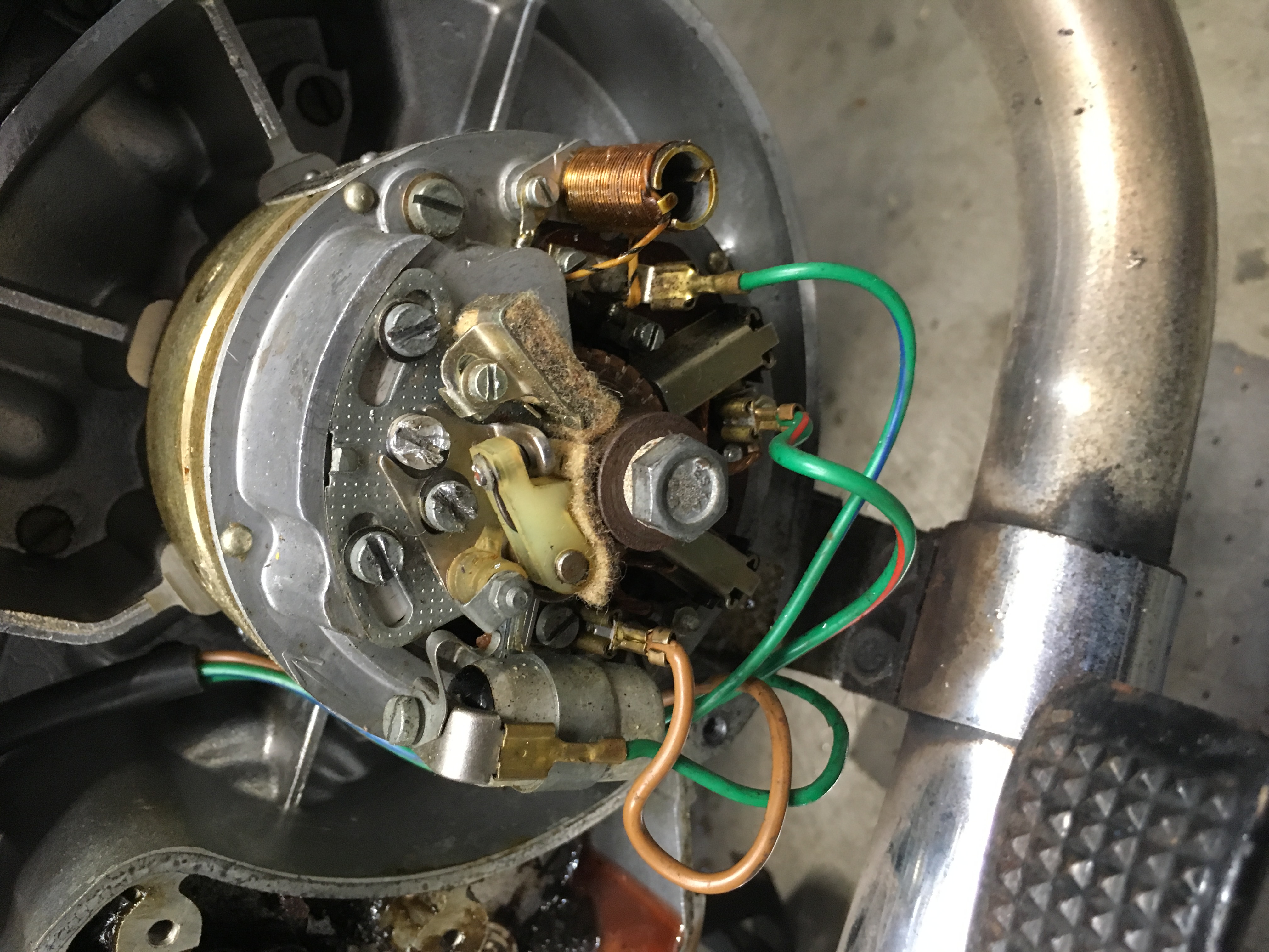

I have a couple of images here that to me, make the bike seem pretty new and unused... Looking forward to your thoughts.

Postby Blurredman » Tue Jun 04, 2019 6:12 am
The felt attached to the contact breaker itself is normal- it is there to catch excess oil on the cam that would be provided by the other felt. Or so the factory manuals say. There is a rectangular hole so that the points foot is not lying on the felt- but the cam.

Looking at those butchered screws makes me think this bike has lots of miles on it. The first thing I would do is burn out the muffler. I have to do that twice since 1985 on my ETZ and many times on other two strokes.

Postby Andy_C » Tue Jun 04, 2019 10:20 am
Whether the felt should be under the heel of the contactor breaker or not I would remove - surely it will affect the opening / closing / gap of the points - I would at least try it without the pad.
My ETZ once had problems with intermittent running / stalling, that was down to electrics, I checked all of the connectors and tightened them up - just slightly close them with a pair of pliers and re fit.
Some were pretty loose.
Ever since doing that it has run faultlessly - worth a look perhaps?
